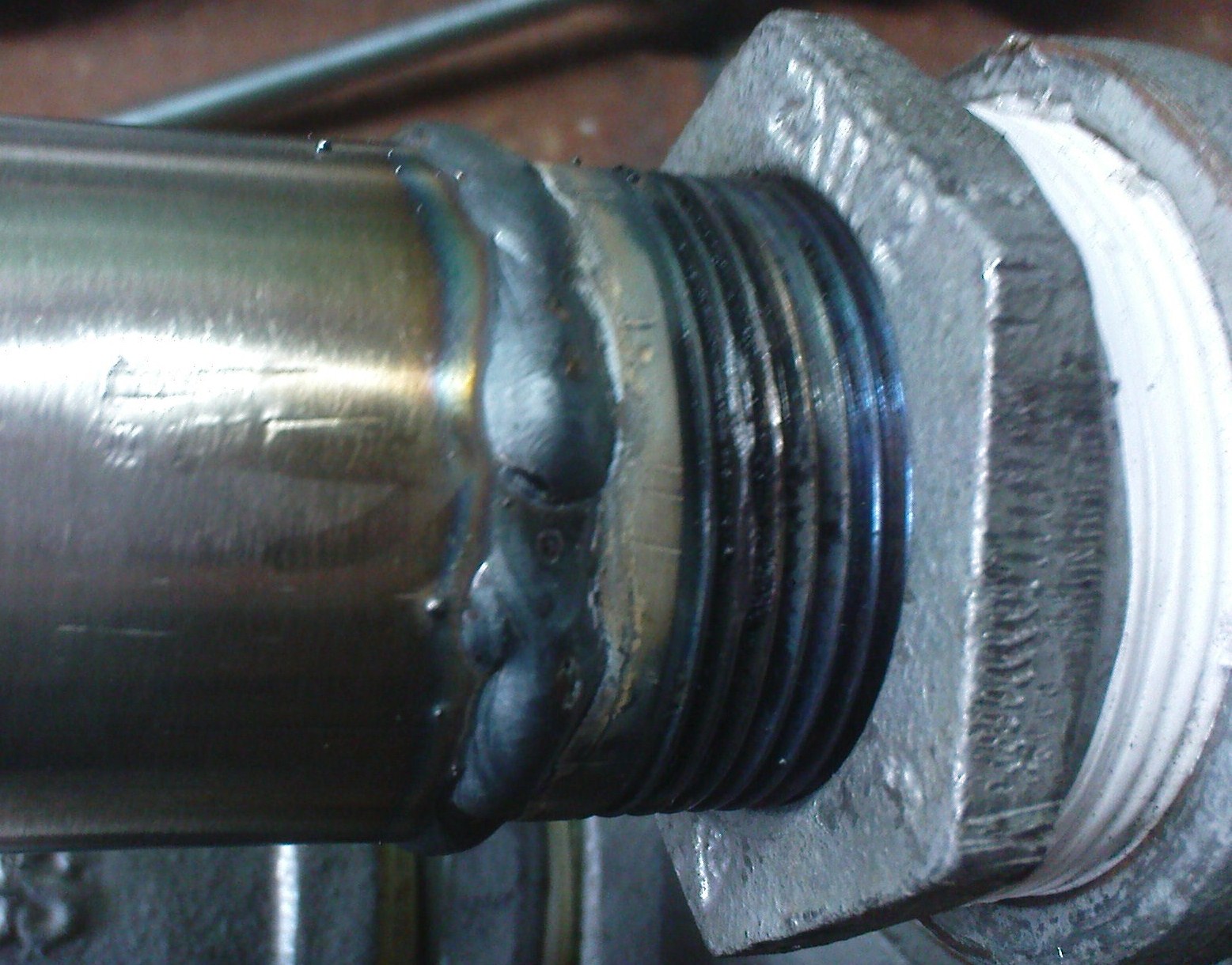

Removed the epoxied fitting from the barrel, I barely touched pipe wrench to barrel before it came off. Took the barrel off to get welded, I believe he's MIG welding the malleable iron fitting (with galvanised coat removed by me) to the barrel.
To make sure it all lines up straight, I found a 1.5" metal ball valve that had its seals destroyed by the hybrid and removed the smaller half from it (the right side in
this picture) which allows the guy to thread the 1.5" nipple in to the ball valve half and lay it flat side on the ground with the nipple facing up. He can then place the barrel over the nipple to make sure its 90° to the ground and tack it in place or something.

Looky what I have here
He only charged me $20 even though I offered $30 (he originally said it would cost $30). The barrel is nice and straight, about as straight as you can get it. Beautiful.
Now I just hope you guys aren't going to criticize the welds

MrCrowley wrote:Looky what I have here
No criticism here...
nope none at all
As long as it holds, its a sexy weld in any spudder's eye!

Tue Nov 08, 2011 9:27 pm
Perhaps I should loan it to JSR before I shoot it
Does that imply JSR's not sexy enough?
or...
...that you have no hope to find it after you shoot it?
The little blob and bulges are... kinda... interesting!

Tue Nov 08, 2011 10:09 pm
That honestly does look very professional. :laughing6: It should hold but it is by no means pretty.
