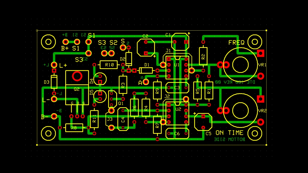

Here is a parts layout for you.
I will e-mail schematic and PCB file.
Schematic
Schematic
Actual Component Side<br />Called Silkcreened
Called Silkcreened
Yellow is Component Side<br />Green is bottom foil/wiring side

Thank you very much dewey-1 !
