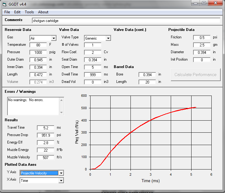

I put in all the info I knew onto GGDT and I got this:
Travel Time: 8.5 ms
Pressure Drop: 957.9 psi
Muzzle Energy: 0.3 ft*lb
Muzzle Velocity: 27 ft/s
I probably entered in some of the information wrong but I'm glad you can do it for me :)

hmm, seems like you right about it having practically no chamber volume... Even for 1000 psi thats pretty small... :? Are you sure you cant make it just a bit longer? That 27 f/s actually sounds about right.

Assuming a 20 inch barrel, 10mm calibre and an extremely thin barrel wall inside the cartridge (:roll:) for 2.5 grams of BBs and sabot I got around 500 fps, pretty healthy.

aha! So my design did work after all? but You said 2.5 grams of BBs. Try it with 10 grams. 12 BBs that are 3mm in diameter is roughly 10 grams. I might just increase the length of my cartridges by 10mm - 20mm just for a bit more power. Thanks a lot JSR! And 500 fps! That's heaps! I think I read on the Farco Air Shotgun website that the Farco got 300 fps.
