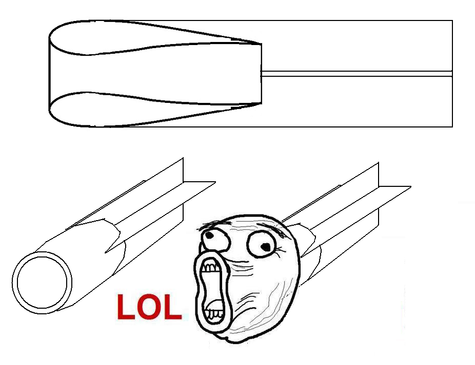

I saw this new blade-less fan from Dyson, it uses the Coanda Effect to multiply the air going into it to up to 15 times the volume going out of it.
The design uses an airfoil shape wrapped around into a circle, and then uses pressurized air coming from a small opening around the rim of the circle to induce a low pressure in the center of the circle, thus producing air flow, once you see the YouTube video, you'd understand better.
Any ways, I was thinking of a projectile that could use this same shape, it could possibly be longer, and have low profile fins to stabilize it in flight. My hypothesis is that it will act like a ram jet in a way, or "glide" a bit further than a projectile with the same weight. To shoot it, a sabot would be used, one that would resemble a shot gun shell wadding.
What do y'all think? Do you think it might work?
- It would probably have to be longer than this, but you get the idea...
- projectile_idea1.jpg (32.92 KiB) Viewed 6294 times
Tubular bullets are an existing concept, like for example the PMC ultramag:
The ring airfoil grenade is also something that has been played with for a while: http://www.angelfire.com/art/enchanter/RAG.html
In terms of sectional density, it has the same effect of a saboted dart, reducing the frontal area of the round and therefore drag.
It would be interesting to see some experimentation of one were so inclined

Thanks for the link! I didn't even know that they made those! I really want to test this theory, but I don't have a lathe, or a mill... I could probably figure something out though.
I'm going to be working on a larger scale than bullets, I have a few pneumatic launchers, the barrel of one is 1", and I have two others that have 1 1/2" barrels.
Is there a way to get the rounds spinning? do you think that if I turned the fins a few degrees, it would cause the round to spin, or just wobble in the air?
Those tools would have been helpful but there are other options for the short on cash and resources but long on patienceinventorguy1000 wrote:Thanks for the link! I didn't even know that they made those! I really want to test this theory, but I don't have a lathe, or a mill... I could probably figure something out though.
If you're putting fins on, I would avoid trying to make it spin.Is there a way to get the rounds spinning? do you think that if I turned the fins a few degrees, it would cause the round to spin, or just wobble in the air?
The fins you drew are pretty small though, I would make them much bigger, like so:

Those tools would have been helpful but there are other options for the short on cash and resources but long on patience Wink
I'll look into that, and I have a TON of experience with with patience
So, should I make the fin length as long as the body length, or like 1 1/2 times the body length?
I won't have time to work on this until the weekend, I have double shifts at work tomorrow, but i'll post on what i came up with!
It's all a matter of where the centre of pressure and centre of gravity is, some recommended reading.inventorguy1000 wrote:So, should I make the fin length as long as the body length, or like 1 1/2 times the body length?
