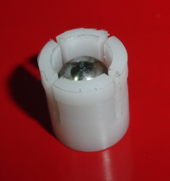

In the meantime, here's a sabot for an 8mm ball bearing in the smoothbore barrel. What I did was drill and 8.5mm hole but leave a 12.5mm diameter lip at the front end. Because of the slits, the front part is flexible and in the barrel will bend and grip the bearing tightly. However when the sabot leaves the muzzle, it will spring out and release the projectile making for smooth separation. That's the theory at least ;)

Sat Apr 14, 2012 4:53 pm
*Long elaborate theoretical explanation"
"That's the theory at least"
Sorry but that never works :D

Gun Freak wrote:Sorry but that never works :D
I think my response is best summarised as a suggestion that you google "ipad fleshlight" :D

Jack, you could insure a smooth separation by left the 12.5mm lip in both end and cut the sabot all the way down, instead of only half of it.
Sat Apr 14, 2012 5:33 pm
wyz2285 wrote:Jack, you could insure a smooth separation by left the 12.5mm lip in both end and cut the sabot all the way down, instead of only half of it.
If you cut it in half completely then you would need a separate pusher plate, and a three part sabot is more time consuming than a one part one ;)
Speaking of three part sabots though, this might work for the arrow. My concern would be the shaft snapping in the barrel because the arrow is centred on the tips.
