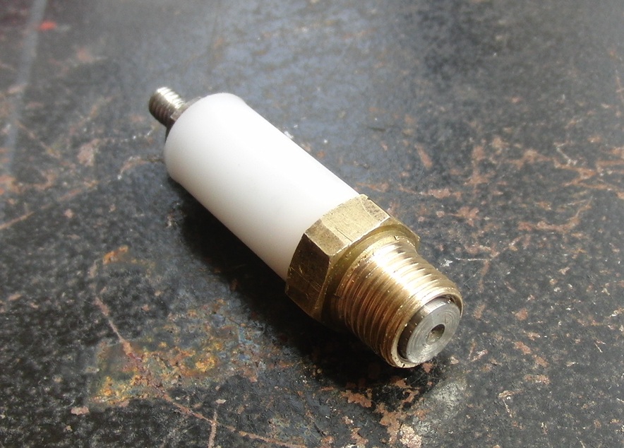

Hybrid ThorJack
Sun Apr 15, 2012 4:31 am
Somepromise of the future ;)

very nice spark plug!
thread 1/8 NPT-BSP?
shooting a 18x looks great!
Sun Apr 15, 2012 1:08 pm
Petitlu wrote:thread 1/8 NPT-BSP?
You said BSP no?

Great to see JSR being very proficient at designing for machineability!
His epoxy stash is going to reach its "expiration date", due to his new found capabilities! :D

Yes BSP!
I had not realized it was this beautiful spark plug for me!
you are too generous!
Thank you!
You may have spoken too soon, apparently he has still thrown in some epoxy in there for good measure :)
Sun Apr 15, 2012 1:30 pm
dewey-1 wrote:His epoxy stash is going to reach its "expiration date", due to his new found capabilities! :D
As to marine epoxy, that might actually be true!
Araldite application is easier than o-ring grooves ;)
I don't want you to have any excuses for not shooting at 40x :D

Mix 50 would be dangerous? :roll:
Sun Apr 15, 2012 2:21 pm
Petitlu wrote:Mix 50 would be dangerous? :roll:
paintball tanks usually have 5000 psi burst disks, I think you'd be pushing your luck ;)

Sun Apr 15, 2012 2:32 pm
yes, but the tank is pierced less resistant ...
Sun Apr 15, 2012 2:34 pm
Exactly, so stick to 40x ;)

it's true!
Mix40 is already very powerful!

Just wondering if anyone has any qualms about using brass fittings at 40x mixes?

I have brass fittings provided for 5000psi .... :wink:
Sun Apr 15, 2012 5:04 pm
In that case you may proceed to 40x :D
