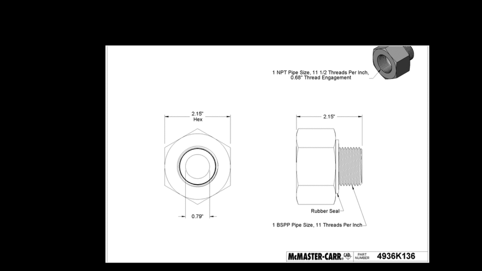

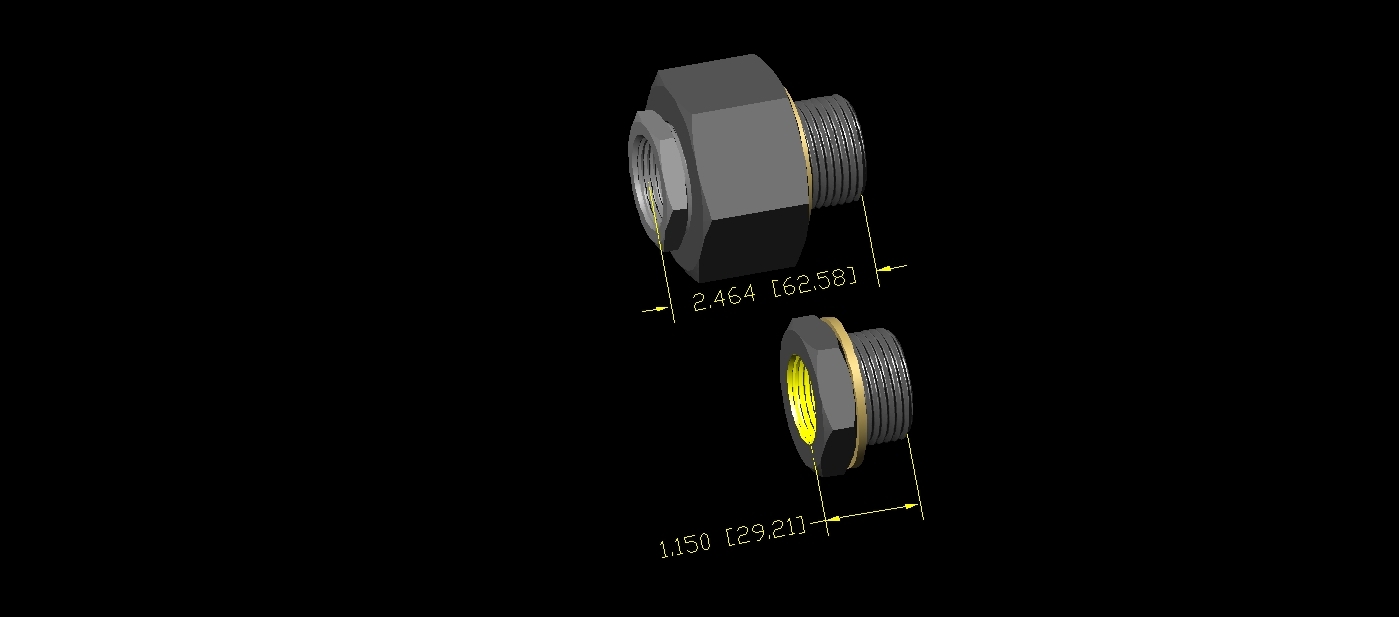

As the title says, I need to connect something with male 3/4" NPT threads to something that has female 1" G threads. A direct adapter does not exist (afaik), so what other options exist that would minimize dead space?
Tapping a 1" G plug maybe?
Or will a male 1" G to female 1" NPT adapter plus a reducer bushing not actually create significant dead space?
That's probably what I would go for.

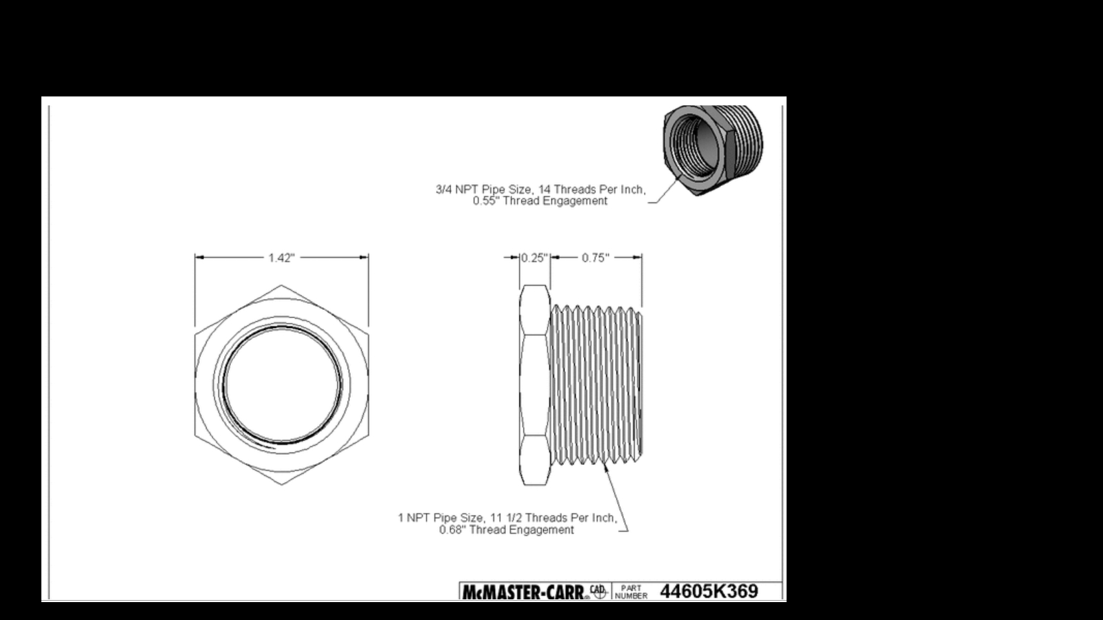

Here is the minmal machining method that is probably cheaper unless you already have a 3/4 NPT tap and correct drill size.
As jsr mentioned the tapped plug is better as can be seen in this picture.

Thanks for the pictures, Dewey! I do have a 3/4" NPT tap but I'll need to find a 59/64" drill bit.
I'm concerned about making a centered hole using my whacky drill press. Would you advise drilling from the hollow end, or drilling from the closed end using progressively larger bits?
dewey-1
Posts: 1298
Location: NE Wisconsin USA
Thu Nov 01, 2012 5:15 pm
PVC Arsenal 17 wrote:Thanks for the pictures, Dewey! I do have a 3/4" NPT tap but I'll need to find a 59/64" drill bit.
You could also use a 15/16" drill.
Get a a cheap Harbor Freight machinist (drill press) vise. Well worth it!
Center punch accurately on the flat of the hex side.
Start with 3/16" as a pilot and progressively enlarge. Use oil to keep drill bit cool and aid drilling.

Undoubtedly BSPP threads, not NPT. But, NPT male threads into them no problem. In fact since it's a straight thread, the additional insertable depth almost makes it seem more secure than the typical NPT-NPT connection which offers less engagement.
It doesn't seem like blow-out would be likely. If anything goes wrong it would probably be leakage. I'm tempted to go ahead without adapters and just use a ton of pipe dope and teflon tape.
