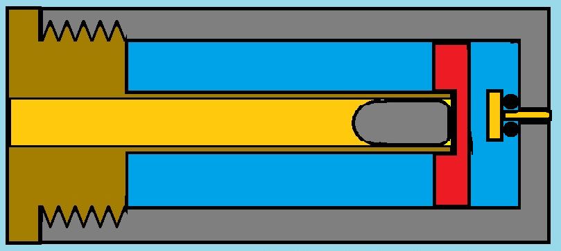

Did anybody try this yet:
Sat Jan 12, 2013 3:56 pm
Why not this, that way you don't have to dismantle the cartridge and replace the burst disk every time.

Sat Jan 12, 2013 4:39 pm
With one spring keeping the piston and poppet in place...I knew you'd say that. :D
The way you portrayed it will have the poppetthingy sqeeze off the O-ring..
I realised I should have drawn the hammervalve type in the first place after I uploaded it.
The reason I didn't change it is because with a sharp enough spike, you'd need less force to hammer it at 80 bar+
The "gun"that would fire the cartridge would also be evidently different from a firearm, wich would be smart to avoid a misunderstanding about it's legality.
It should also have a ridge to extract the cartridge from ., perhaps.a..breakaction doublebarrel?. 8)
..and the cartridge is then put into the bottom of the pump so the plunger can stay in..

I'm more interested in learning if anybody has tried something like it...and if it worked well..
I'd like a 8-10mm projectile and still shoot clean through a steel can.
Assuming the cartrigde would just about fill up 3/4 length of a slightly fattened sawed-off...
What kind of pressure would it take if the cartridge would be 22-25mm O.D.?

I'm still convinced a coax piston type cartridge is best.
I might try the burst disk to pilot.
It will be less complex and very compact.
Only time will tell if it's too cumbersome to open the cartridge and drop in a precut aluminium disc.
( holepunch and redbullcan)
Piercing a burstdisc at high pressure isn't very hard

The idea was to have it as a cartridge, still haven't given up on the idea :) my options on the table are either make a "proper" machined version of the valveless design which requires an external gas source, or focus on perfecting hybrid cartridges.
The problem is that cartridges need to be small to be practical and "realistic", and a coax design automatically robs you of chamber volume for a given length and external diameter.
No doubt it will work well, it might just get annoying to have to change the disk every time. Still, a sawn off side by side uses much less ammo than a magazine fed "assault rifle" type launcher ;)
