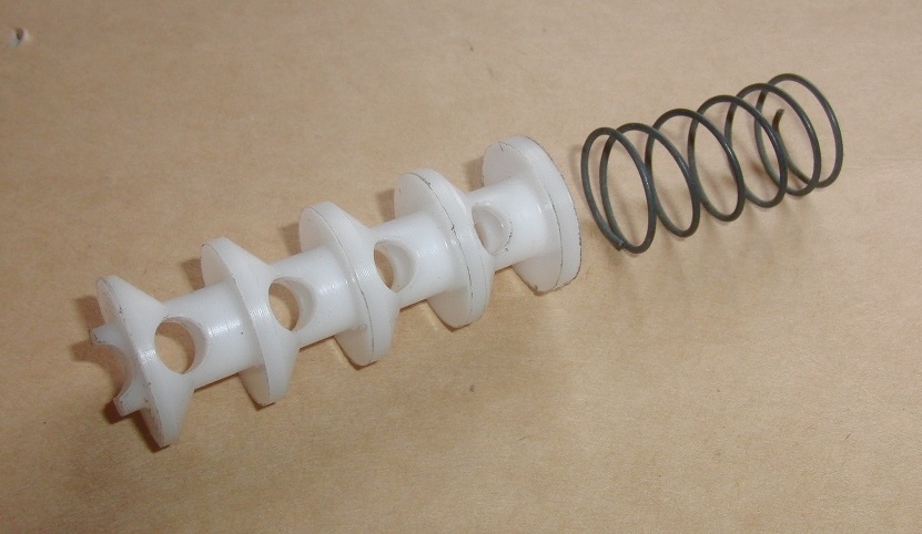

May I know the shape of the parts and how they will be assembled?
Has thanked: 581 times
Tue Apr 30, 2013 2:03 pm
I was thinking of a monolithic core similar to the part here and a spring to keep it tight.

Hum I was thinking something like this
Not sure if there is enough space for such through.

This is the original set I had made for Jake:

In your opinion, does independent baffles work better than only one core? I haven't tried any yet so, you're the specialist, you decide :)
Tue Apr 30, 2013 2:49 pm
Doesn't make that much of a difference to be honest, especially on a springer where most of the noise comes from the spring anyway and the volume is so small.

Make sense. Then do whatever you think it's easier :) meanwhile I'm looking for a new scope for it.

Its actually funny how big difference baffles make though 97k is a springer. It reduces the sound and makes the gun sound even more pro :D

Here's wyz's monolithic baffle stack to complement the fine example of German engineering he wisely chose to invest in :)

Nice! When I saw both email notification from this topic and a pm, I thought it was about this :D can't wait to get it.
