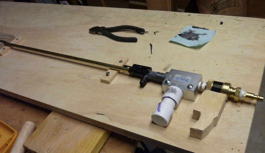

Well, two weeks later and most of my parts have arrived. 1/4 inch QEV and slide valve, .25 gram bb's, rifle scope and rails, etc. Just waiting for my 65-round magazine to come. Some pictures of the internals while drying:
Some test shots at 80 PSI and it will send a bb through 3 layers of cardboard at close range. Don't have a chronograph, but I'm assuming above 400 FPS? An idea I had was to make a board with marks for each inch, and record the bb flying with my 240 frames per second camera.

I see you've gone for the commercially available breech, interesting!
240 fps is not really enough for meaningful data.
1nxtmonster
Posts: 91
Joined: Wed Oct 02, 2013 3:36 pm
Sat Dec 07, 2013 9:30 am
Yep, I've gone for the commercial breech. I figure that the more off the shelf, standardized parts I used, the easier it will be to build and repair. It was pretty interesting to attach to the pipe nipple; I had to solder a brass pipe to the inside of the iron nipple, then "crown" the other end to fit it over the breech. And of course, it wouldn't be complete without a good lather of epoxy :)
