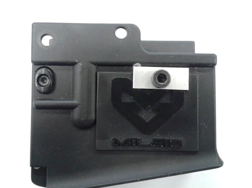

Something that I've been playing it over the past couple of days, converting a Milsig K-series paintball marker to take RAP4 DMAG 20 round magazines, worked out pretty well.
some photos of the mods done:
On the marker body itself, lower rails next to the paintball port milled off to allow the DMAG to enter the magwell enough to click against the catch.
Bottom view of modified magwell showing white delrin spacer and tab to open feed lip
Top view of modified magwell showing area milled out to allow mag entry
External view of feed lip tab bolted on.
Magazine follower modification (modified follower on the left) showing steel pin to limit travel
Comparison of modified magazine on the right and unmodified magazine on the left showing travel limit in order to stop the last ball being chopped by the bolt.

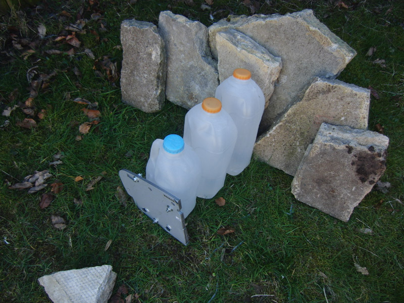

I decided I really wanted to blow something up today.
So, I took some scrap 1.5mm steel (from some computer cases I recently threw out) and cut it up so I could bolt four layers of the stuff together:
I know it's not that impressive a target - it's only mild steel and it'd be a lot stronger if it weren't in layers, but I'd guess it's probably still capable of catching many pistol rounds.
The full arrangement was as follows, with some water jugs behind and some concrete as a final backstop:
And, of course, there's a video:
And so, one hole through some steel plates:
And some holes through the water jugs too:
Watched closely, the video shows the penetrator bounce off the rear backstop, bounce again off the concrete to the left side pieces, then again off the water jugs before landing in the grass. With that in mind, I'm fairly sure it would have had the energy left to go through more water jugs if I had more spare - I don't know how many though, as it was starting to turn sideways in the third jug. (However, treating water as an injury analogue, a three inch long penetrator going sideways would certainly have some interesting effects.)
