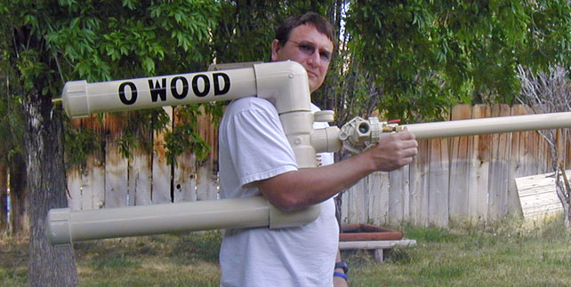

I pilot my sprinkler valves with a smaller sprinkler valve. Here is a 1" valve piloted by a 3/4" valve.
I hope this helps.
I hope this helps.

- Many years ago D_Hall piloted his 2" sprinkler valve with a one inch Sprinkler valve.
- 00wood03.jpg (43.9 KiB) Viewed 6752 times
