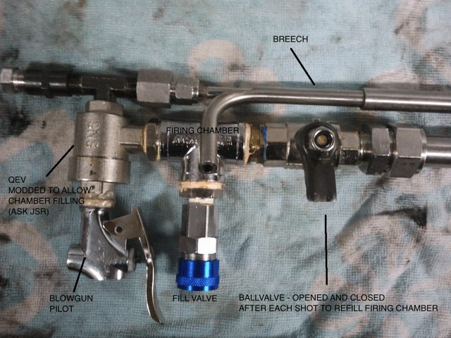

this is the main workings of the gun. refer to the labels to see how it works.

A short question: you said you pumped to 260 psi, but i'm wonder if it is safe for the QEV with that high pressure (when the working pressure of such 1/4'' valve is approx. 150 psi ~ 10bar)?
Thanks!
Has thanked: 581 times
Sat Dec 20, 2014 9:38 pm
Some folks have taken 150 psi rated QEVs to 500-600 psi with no issues other than increased diaphragm wear. It's never a good idea to exceed the manufacturer's ratings, but in the vast majority of cases as long as you don't overdo it, it's unlikely that a catastrophic failure will occur. At your own risk, of course.
