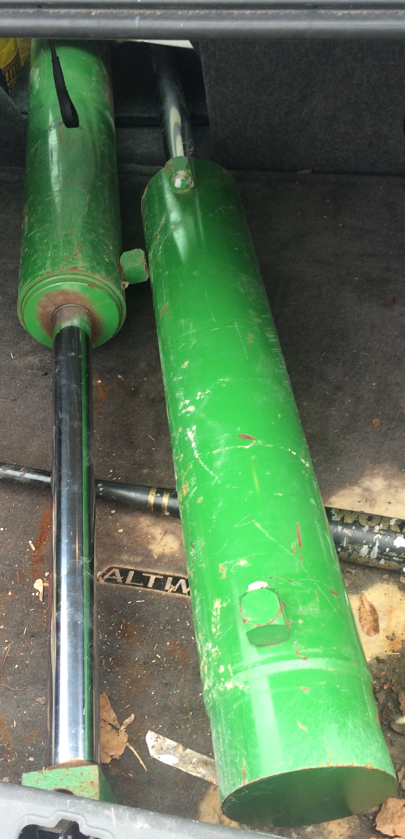

Hey, I did actually do that test, just did not get anything up because it was not quite as exciting as previous tests. The sphere was rather loose in the barel so did not seal as well and there fore had less energy. It did split the oak log it was fired in to. but only penetrated about 3". Currently I am working on getting hydraulic cylinders to add to the breach so that it can be easily opened and closed and the bolts will no longer be required. Eventually hydraulic elevation and possibly traverse are a possibility, and idealy a built in compressor with the whole thing on a trailer. Eseentialy the idea is to have the whole thing powered by an engine so no outside power is needed and have the movements mechanized as it really is a beat to lift all the parts back in line after it fires.

You can get hydraulic cylinder pipe from steel pipe sellers, same pipe that is used to manufacture the cylinders. That has very good roundness and surface quality also it's very good to weld. (Or you could cut a section of some used hydraulic cylinder)wdr0 wrote:I realize there may not be anyone who can answer but I'll ask any way. I have a question for those with metalworking experience/knowledge. I am considering attempting to build a piston valve for this cannon and was thinking I might use a section of a compressed gas cylinder (something like a 125 cf nitrogen cylinder)for the piston housing. What I'm wondering is if those cylinders are a reliably weldable alloy of steel? Also I am aware of the safety aspects of working with a cylinder that may have flamible residue or gases. I would appreciate any input, Thanks!
I would not use gas bottle, they are made by forming from sheet metal and welding could stress it and also it would probably deform when welded.

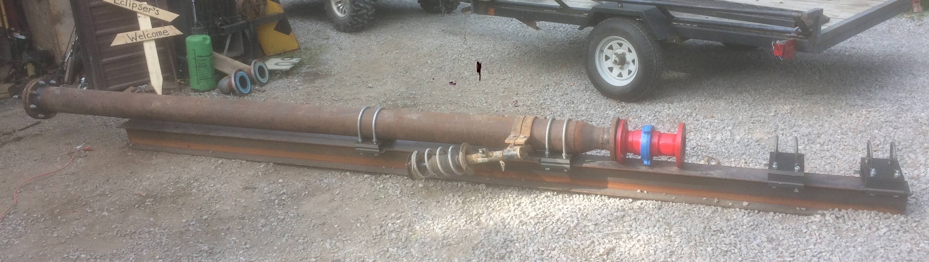

hello all, update here, this project has been on hiatus, moved at the beginning of the year. I was able to do some work durring a visit home with the help of some freinds. The remaining work should be completed before November by my freinds with test firings of the new arrangement in early novemember. Here is the current progress.

May be a bit late to the game but....
Large projectiles go a very long ways when elevated even slightly. VERA only elevates about 5 degrees but I get "first impact" points about a mile downrange. The point being that you may want to re-evaluate the angle of the dangle on that gun mount to make sure it is compatible with the realities of your firing range (whatever they may be).

The implications of the high elevation range were indeed discussed. I did decide to allow for that much range mainly because many of the other areas where I may fire from are not flat and the increased range will allow for firing at a basically horizontal trajectory even if the trailer is facing down hill on an incline which is fairly likely. We are aware and have taken into account the long range abilities and possibility of projectiles passing out intended target. Thanks for thoughts and interest!

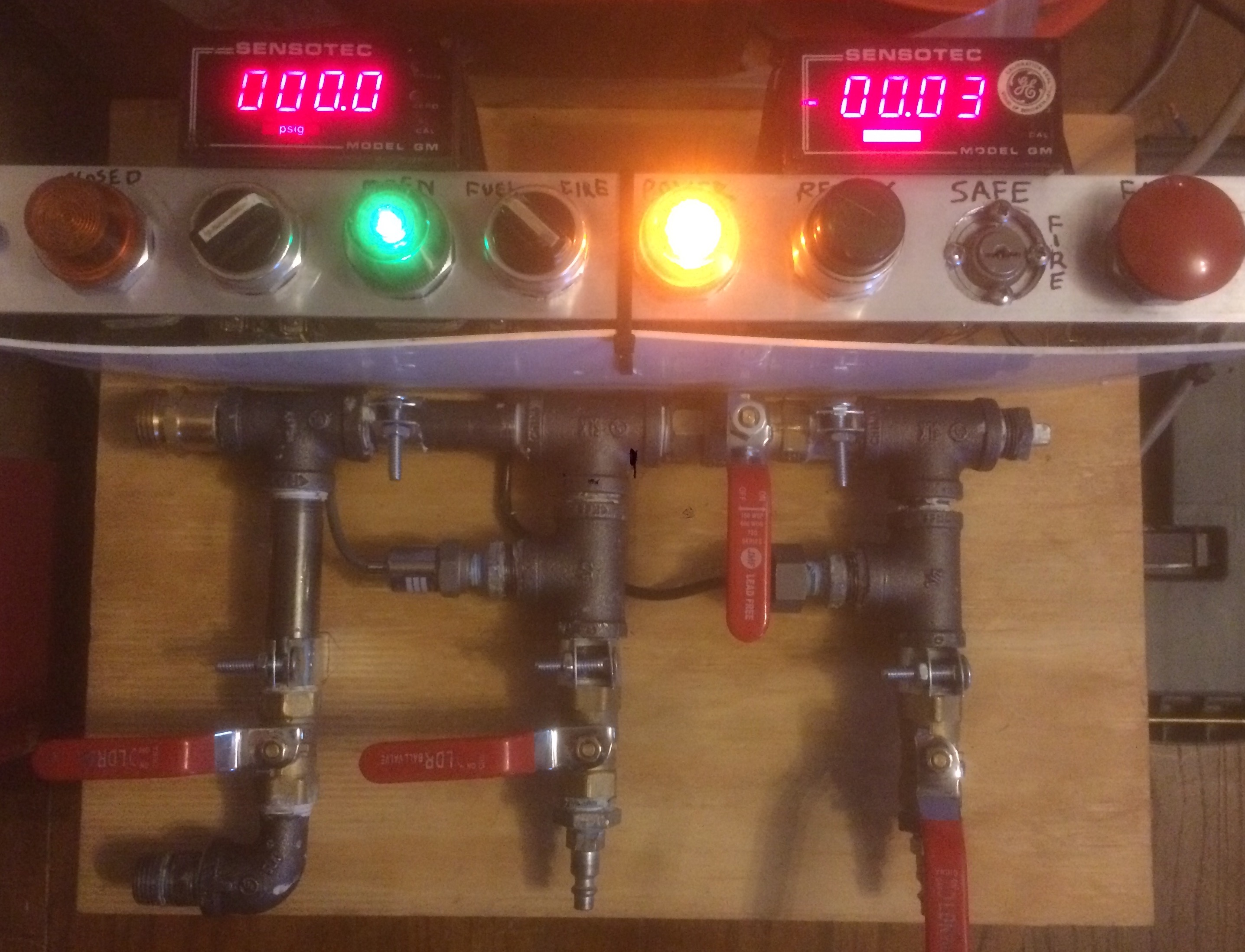

Luckily I had planned for venting the chamber withought a known combustion for both this exact reason or if a leak occurred durring fueling. I have a electric ball valve now installed on the cannon and then a vent off my fueling manifold. So I can vent the chamber entirely remotely. I will have my freind check on the condition of the disk as soon as I can and get the videos up as soon as I have them.
This is the most recent fueling set up. Controls for the actuated valve on the left and firing on the right. Air and propane are the two quick connects, the brass fitting is the hose to the cannon(just a standard garden hose). Lower left is the vent.
