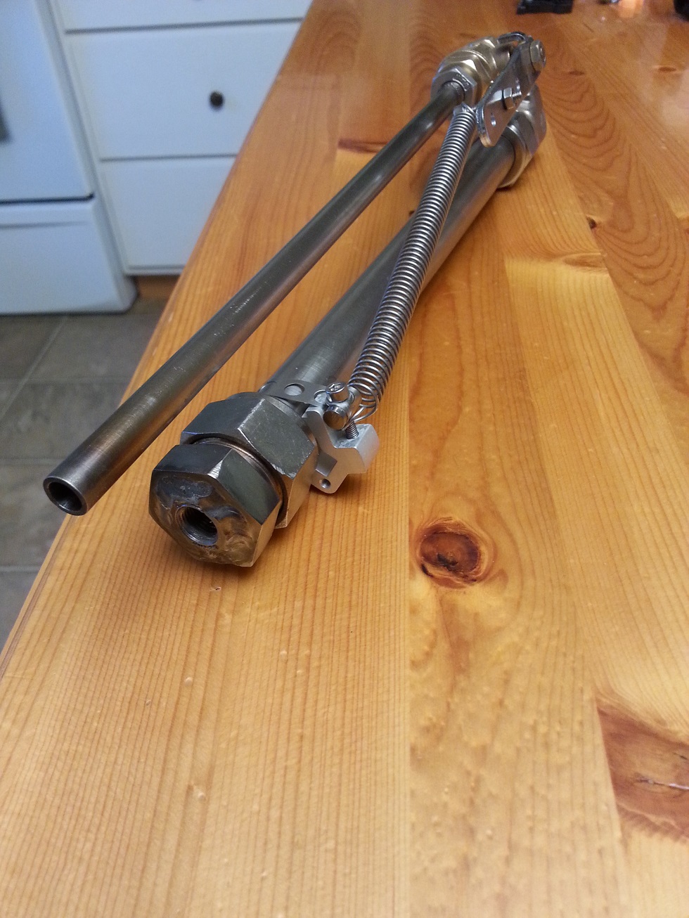

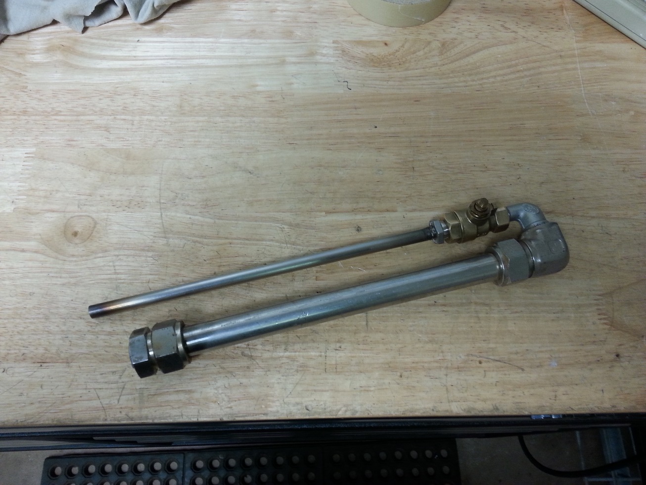

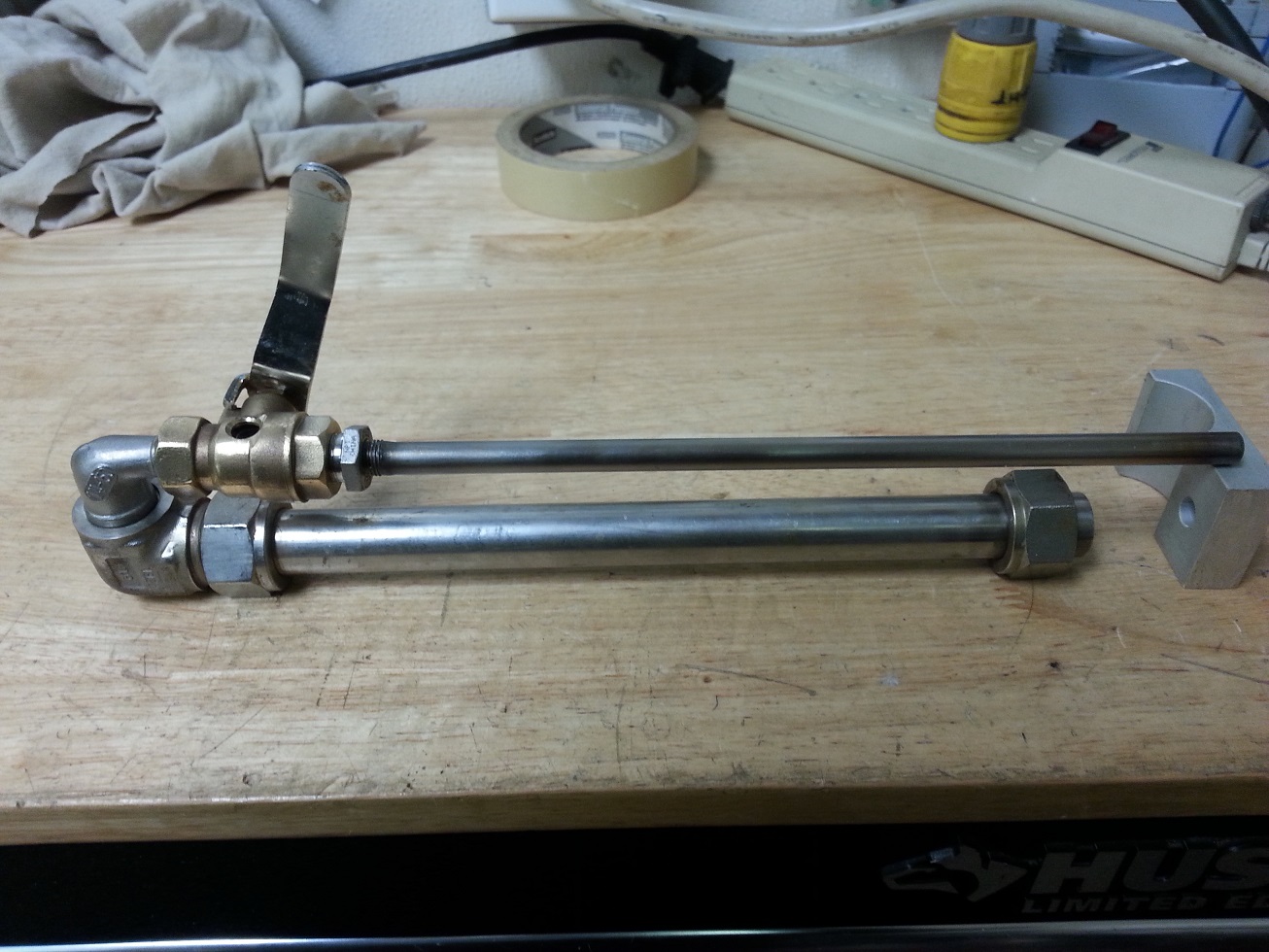

Started to build a flintlock stylie pistol with a spring loaded ball valve.
1/4" threaded ball valve with 1/4" ID barrel and 3/4" stainless tubeing for the chamber. I drilled a hole in the side of the valve as a loading point, then realised that some air would leak out as the ball rotates, was thinking the BB might shoot out the top instead of down the barrel, but it actually works. Put a spring on it and 100psi for some test shots, it was pretty impressive :D Locking and release mechanism will be the fun bit :idea:

Looks great :) How much air pressure do you think you use? How many cm3 of capacity is the air chamber? So what system is filled with air? :roll:

I can take it up to 160psi with my compressor, I might try a schrader valve as I have a shock pump that goes up to 300psi. I think about 70cm3 in the 3/4" chamber, 19mmD x 250mm long. There is a 1/8"npt thread at the front of the chamber, you can't see it in the picture.

Yes, this one is going to be a bit of fun. :bounce:
This is the fill port, and the test spring.

Looking good! Spring loaded ball valves are definitely a fast and relatively easy solution for small calibers that is often overlooked.

Thu Jul 19, 2018 7:03 am
Drilling a hole in one side won't help as it now only has one seal face instead of two, but if it works the reload will be pretty nice :D unless I make some kind of sealed cap that covers the hole and braze it on to the valve :idea:
