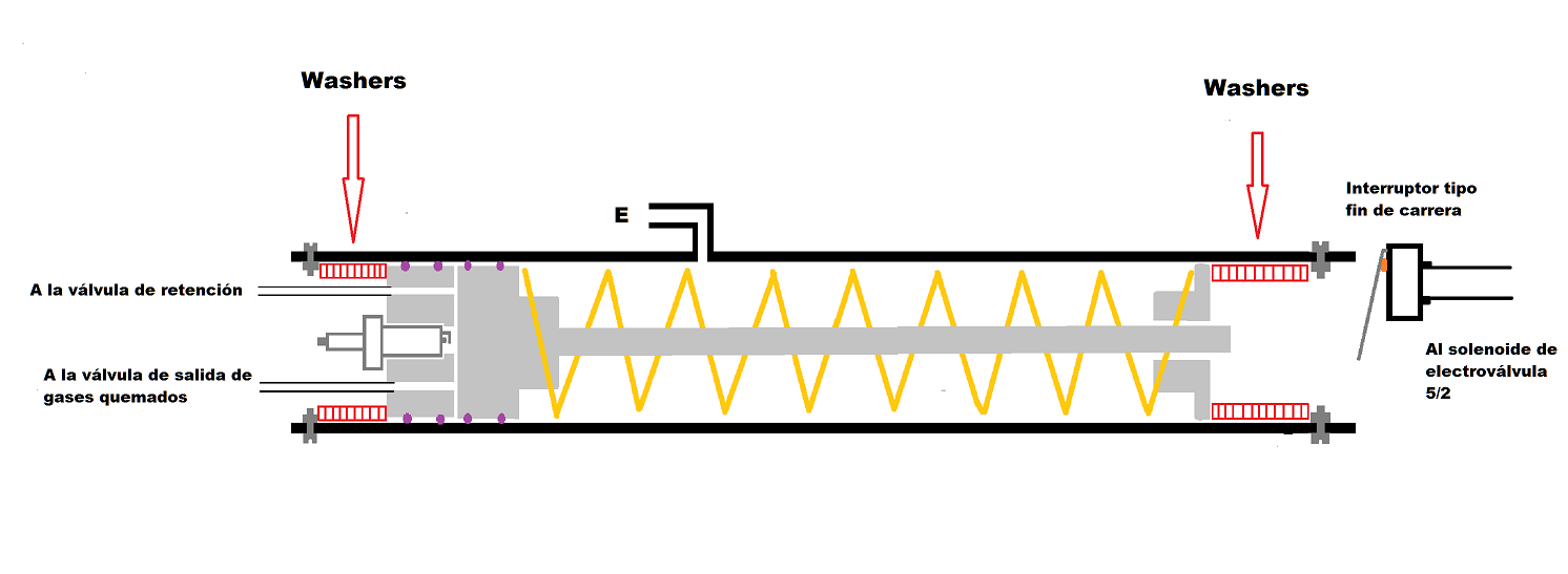

I tell you the following.
I have tried to regulate the opening time of the exhaust port so that it opens before or after. This is achieved by increasing or decreasing the washers, (in red in the diagram), which ultimately moves the piston closer to the outlet orifice. There are important variations in the energy of the shot. The best performances are achieved when it is two or three millimeters, that is, when it does not take long to open. The mass of the piston and spring have to do with this question.
The amount of washers is always the same, so as not to alter the force that the spring makes, they are only taken from one side and put on the other, and the other way.
On the other hand, the ammunition in the firing barrel, which is tight and seals well, retains the gases a little more. Shooting without the ammunition, only produces a soft "puf". When I insert the ammunition, it makes a strong explosion, and I think it is for this reason.
I'm going to make a short video this afternoon so they can hear the difference.
I conclude that to achieve the normal pressure peak in a hybrid, one must consider the combustion chamber, and the firing barrel seal, as unit. Only this way works. The opening time depends on the mass of the piston and the spring, the distance from the piston to the exhaust port. The further away, the later it will open. I have played with this.
It is different with the rupture discs, which produce the peak of explosion pressure, with the combustion chamber alone.

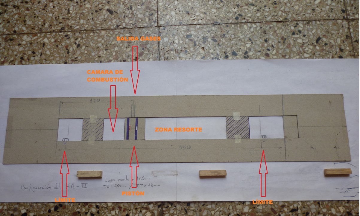

Effectively. The system has that disadvantage that you make notice. The only thing that makes me consider it to use in these prototypes, is its incredible ease of construction, and the possibility of regulating some parameters.
I have built a regulation template, (photo), and based on the program data to calculate the dimensions of the spring, I configure it to perform as best as possible.
In a world of digital calculations I find this analog unit very charming :)
