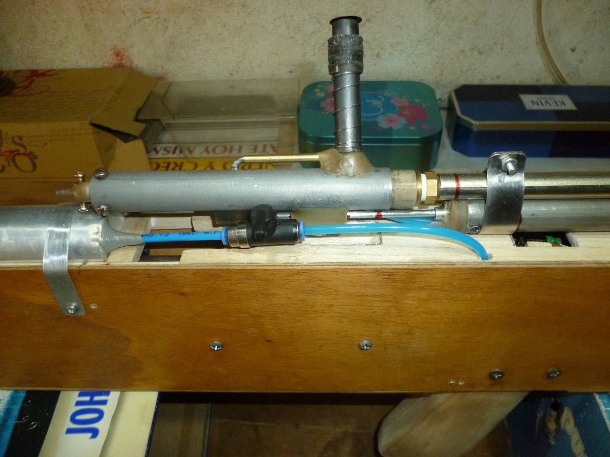

Sat Mar 09, 2019 11:04 am
I have finished the new ammunition loading system with adjustable retention, and it has been successfully tested. The energy of the shot increased a lot. On the other hand, it has no gas losses, and it does not get stuck, which is the most important thing. The gas generator is the HA-SA I, updated with the new system.
I have built a new firing cannon, which has been born better than the others. The firing barrel has a length of 20 ", previously it was 17". I shot it 20-25 times and everything ok.
The pneumatic actuator to move the slide is located below the firing barrel, and is more comfortable.
I have not been able to integrate it into the system because the motorcycle shock absorber tubes, 17 mm inside diameter, are not long enough to do so. They have 170 mm of length, and I need at least 220 mm. :x In the future I will solve this issue.
I still have to finish this weapon, perfect the outside a bit and paint. I have not had time to do this because I am working on the loading system that I present here. Later it will be.
I leave some images of the system and soon upload an operation video. :)
