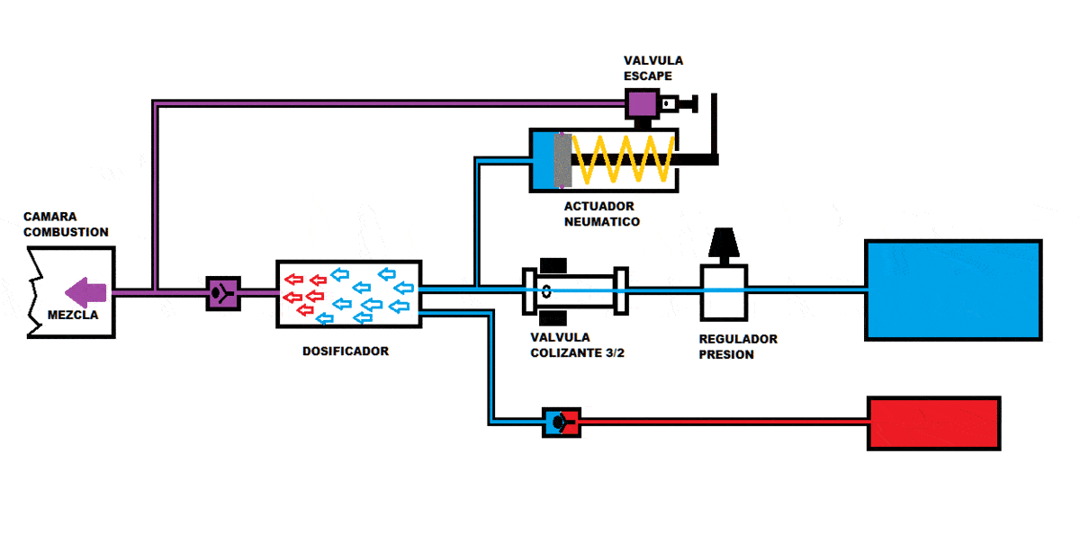

I carried out tests of the system for repetitive firing of the new hybrid that I plan to build :D The caliber will be small, (according to my possibilities of making noise and space), .25, with steel pellets or diabolo, I have not decided yet.
n the tests, I'm using diabolos, because I already had this ready, and the test facility, (not weapon), with recycled elements that I keep just for this.
It works perfectly, I've fired it many times. I leave some photos, and some diagrams.
The "Pneumatic timer" is used to determine the gas inlet time to the doser, about 1.5 seconds. The idea is simply to pull the handle and release. This automatically performs the opening and closing of the exhaust valve, the gas charge and its dosage, and the butane-air mixture charge in the combustion chamber. The system is relatively wasteful, a little air, (is a problem that solves many other problems, more important), in favor of having on board the weapon, the smallest possible number of elements.
If the ammunition is spherical, the operation is reduced to firing and throwing and releasing the crank to make the next shot. The system is the same as I have in my semi-automatic hybrid, (sliding actuated by pneumatic actuator). If the ammunition is pellet, you have to manually load the ammunition and titar and release the crank, and is ready to shoot. In the latter way, I am testing it.
By not using electrovalve, the load pressure can reach up to 15 bar, although I'm testing it at 7 bar, to adjust the design. Today, in the afternoon, I will make a video of the tests. :)
At the end of the post there is an animation of the system. Open the image to see.
Sistema híbrido practicus, (compresión)..png (20.73 KiB) Viewed 11987 times
Sistema híbrido practicus, (escape)..png (9.82 KiB) Viewed 11987 times
Temporizador neumático.png (9.71 KiB) Viewed 11987 times

thanks Moonbogg I show you a simpler version yet, which I was thinking.
All this is for small hybrids, which is what I do. I have not tried it but I'm totally sure it works well. It barely has a doser, a check valve, and a colizante valve with exhaust, (three ways, two positions), I mean with all this, the dosing system, and power. It no longer has any pneumatic actuator. Just move the valve one second, (as the animation shows,) and release it, and you have the combustion chamber, (any), with the built-in mix, ready to shoot. Very practical. Al final esta la animación.
simplificación sist. hibrido practicus, compresión.png (17.03 KiB) Viewed 11963 times
simplificación sist. hibrido practicus, escape..png (16.31 KiB) Viewed 11963 times

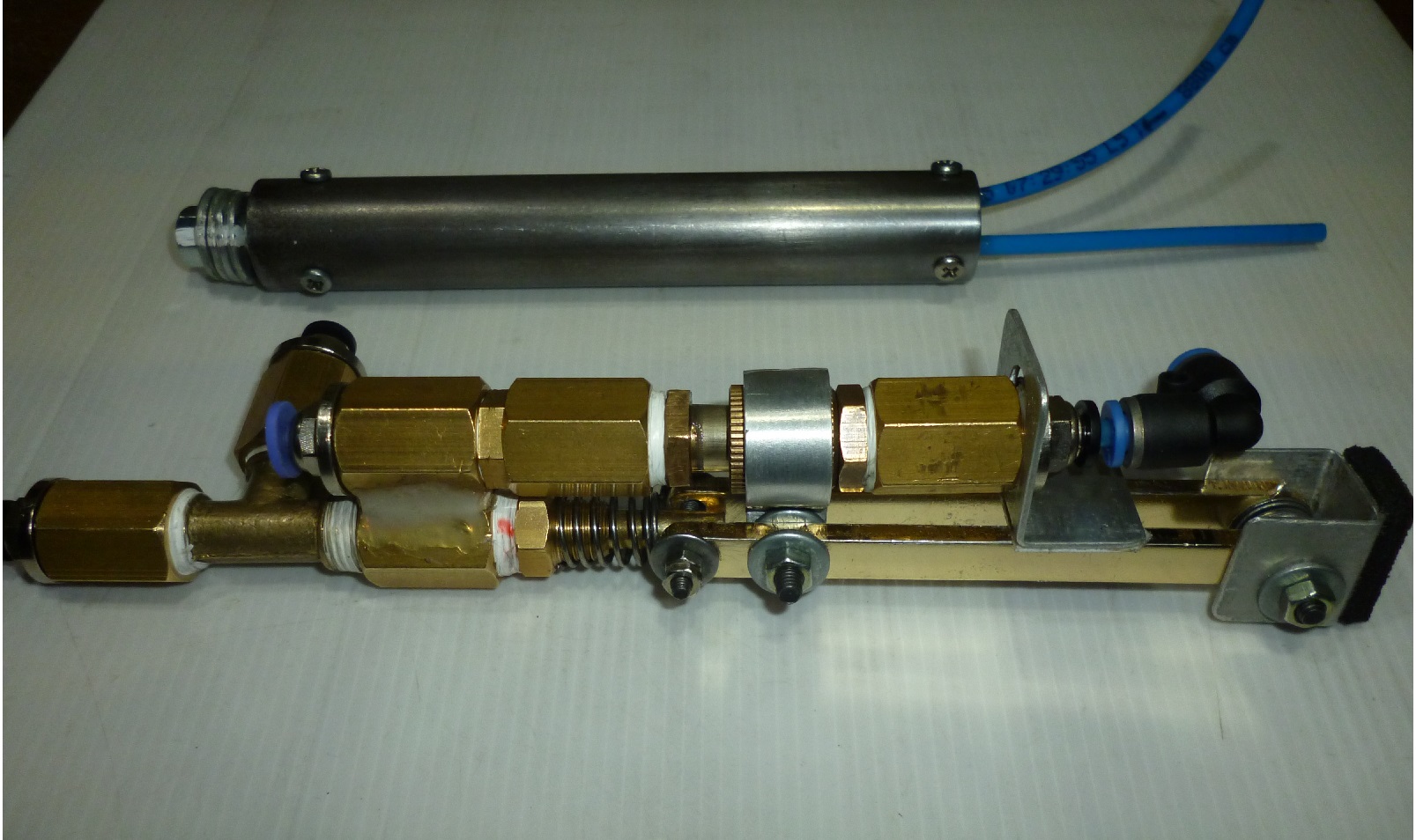

The simplest system just built. It is in relation to size with a common pen to get an idea of ​​the actual size. It consists of the valve body and the variable volume dispenser, (it serves me for several future weapons).
The valve body was designed based on bronze elements, of those used for gas installations, thread 1/4 "bspt, it is very solid, and just press the rod and release, leaving the combustion chamber clean, to zero volume, the dosed gas and all compressed in the chamber, ready to fire, between firing and firing only 5 seconds is necessary, the rest, I mean the firing pipe, ammunition loading and retention system by o´ring, and combustion chamber, is roughly the same as those I have built in the past.
The dispenser was built with a 1 mm thick steel tube, 20 mm inside diameter.
The whole set was successfully tested, it actually works flawlessly, and only consists of these two elements. The test pressures were between 6 and 11 bar, which are the compression pressures that I use in my small-caliber hybrid weapons.
I have thought about installing all this, in a test weapon, (apart from the one above in this publication), to finish making the adjustments. This dispenser can operate between 5 ml and 20 ml of butane. That is the range.
The diagram is this, (I upload it again so as not to confuse it with the previous one, in this same publication).
simplificación sist. hibrido practicus, compresión.png (17.03 KiB) Viewed 11451 times
simplificación sist. hibrido practicus, escape..png (16.31 KiB) Viewed 11451 times
