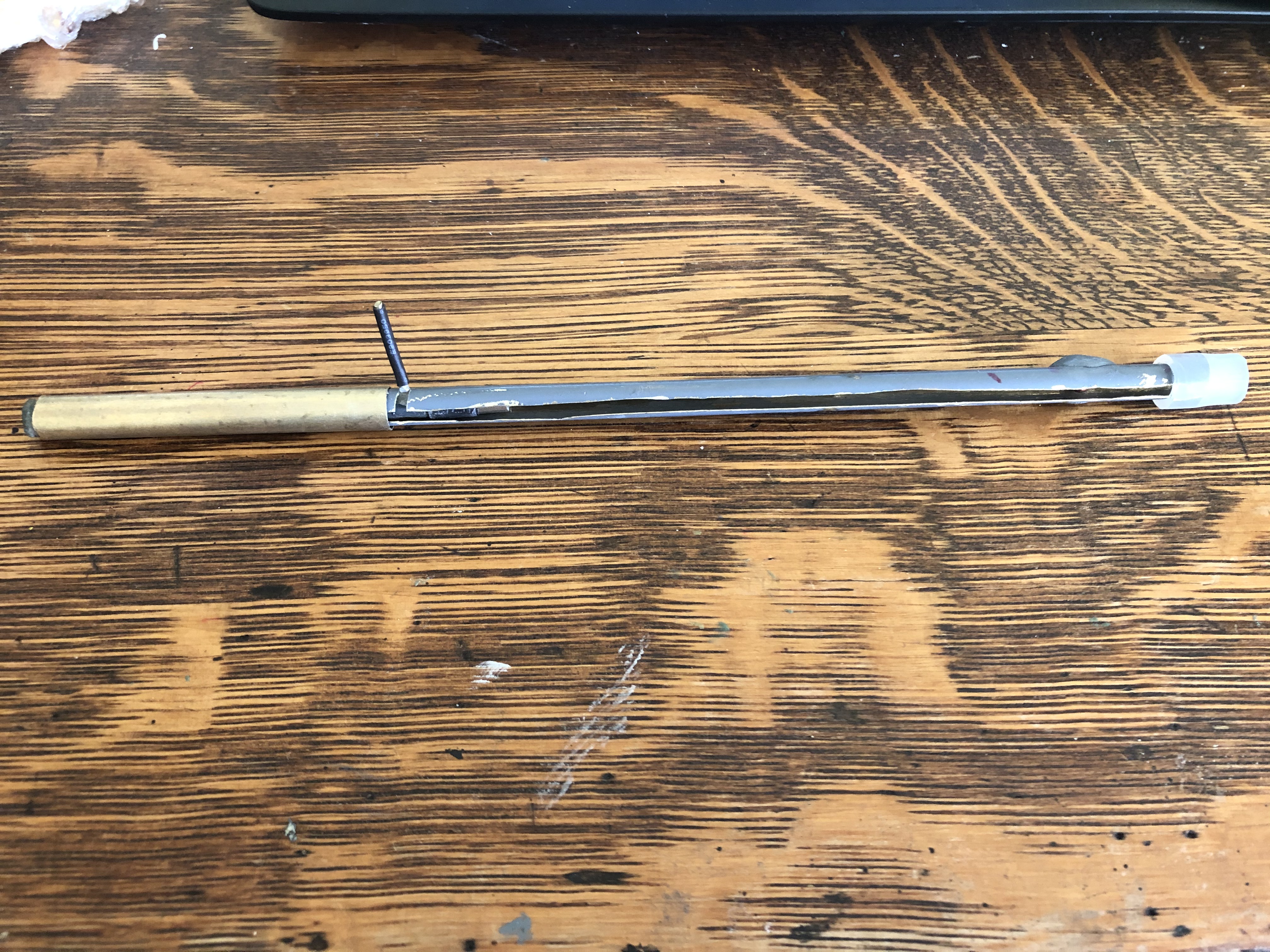

This is a crude magazine I've cobbled together with some brass pipe, compression springs, epoxy and heat shrink tubing. The capacity is about 50 .177 bbs. There's a large "L" shaped groove I cut to allow the follower to push bbs into the barrel.
This shows the magazine in the "locked" position allowing me to load ammo into it.
It seems to work, though I have to manually hold the magazine to the cannon. Otherwise the air pressure is too great and the magazine pops off. The next step is to build a better mag well.
