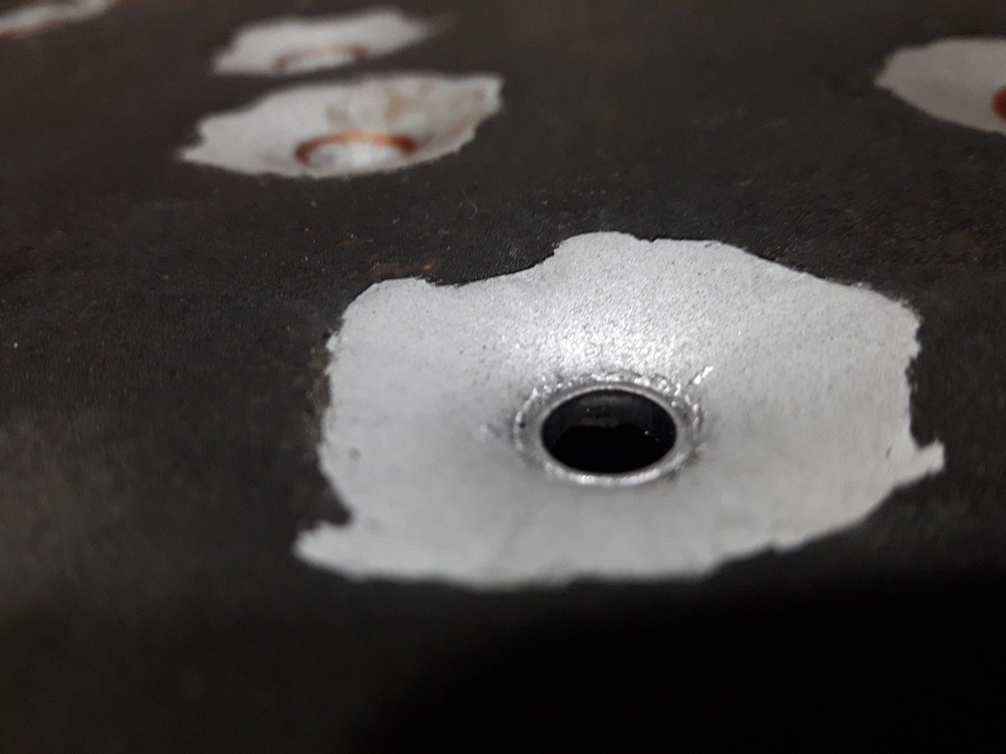

No, I'm just using the gun with two rupture discs. Surely you can break three, with a little more precompression load, I estimate with 10 - 11X. At present it is set to 9X. I think that with the energy he currently has it is enough to play at home, without a doubt, with more pressure he will become more dangerous.jackssmirkingrevenge wrote: ↑Tue Aug 09, 2022 7:02 pmThat's quite impressive for lead pellets to be honest.I can pierce 0,7 mm sheet steel
Have you tried with more than two layers of foil?
This model can shoot with 5 or 6 pumps, which is two power levels. Despite being only a pump difference is noticeable when shooting.
The only thing that doesn't convince me is that the "skirt" of the pellet is "welded" to the target plate, it doesn't pass, only the "head" of the pellet passes to the other side... look at the photo.
