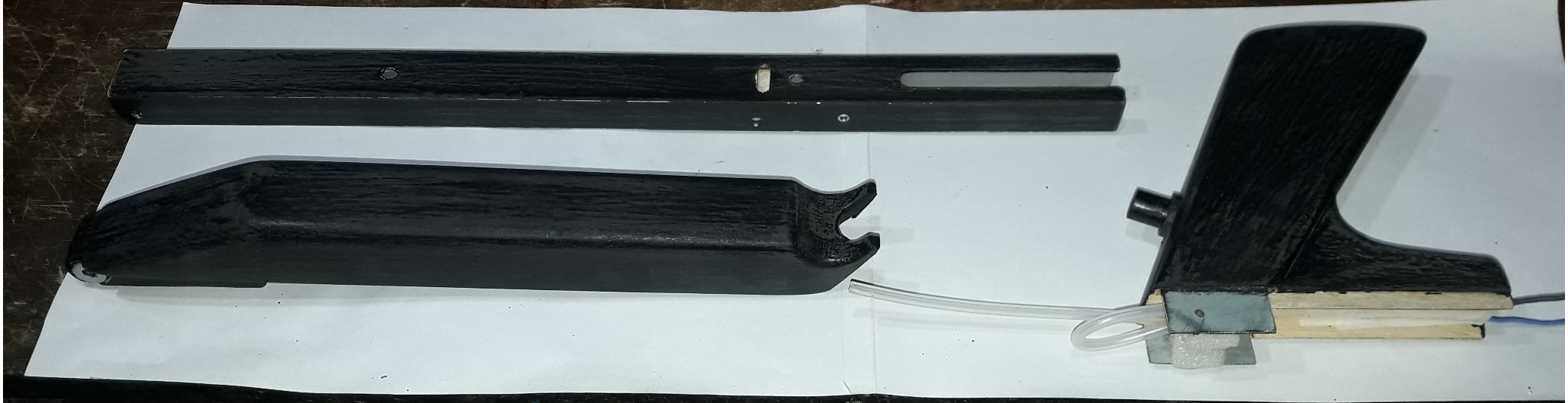

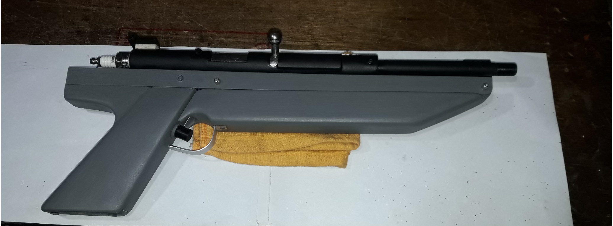

I had this project in mind for quite some time, and I have finally finished it.
This is this .22 caliber pistol that fires common pellets, associated with a rupture disc. The advantage is that the weapon can be supplied in the same way as a common, commercial compressed air gun.
It has an inverted lock, for this purpose.
It's a pump gun. With 9 pumps it has 10X which is the pre-compression pressure of the hybrid.
The small air pump has a 17 mm diameter piston, and the butane dosing system is the one I usually use for these pump weapons.
The firing barrel is ribbed, 310 mm long, which makes it shoot with very good speed.
The lighter is a piezo electric and has a motorcycle spark plug to ignite the air and butane mixture.
The challenge was to include everything necessary on board a handgun. The small butane tank is on the inside of the handle, and is a conveniently modified asthma medication spray.
The main advantage is the ease of operation, and the very low cost of the weapon.
It has a single o-ring at the exit of the combustion chamber, and nothing else...
The pellets are attached to the 11 mm diameter rupture disc, so as not to have to load the pellet and then the rupture disc. It is two layers of thin aluminum foil.
The open sight has fiber optics for better viewing.
The pumping is with little force. I was unable to obtain a 19 or 20 mm tube for the air pump to improve the volumetric capacity of the air pump, and there was no alternative but to use a 17 mm tube.
The operation is in three parts:
1- Load a pellet/rupture disc.
2- Press the gas valve for 1 second.
3- Pump 8 or 9 times and you can take the shot.
A commercial silencer can be included that greatly reduces the sound. If this suppressor, it is quite noisy.

I compared it to a commercial PCP pistol of the same caliber and they shoot the same. Two meters from the target, with the same 16g pellet, they pass through the two three cans of soup. According to the stopwatch of my friends who have the same weapon, it is around 700 to 750 fps with 130 bar in the tank. The manufacturer lies, when he claims 900 fps! I imagine that the difference in barrel length, 21 cm and 31 cm of my hybrid pistol, compensates for the lower pressure of my pistol and they remain the same. Of course mine only cost 30 dollars, and the other 450.... The pellet is loaded the same in both, only in the hybrid pistol, it goes with the small associated disc. It is a valve free gun!

Thank you very much for your congratulations.
It has two discs which is what seems to give more energy, in this weapon and other similar long weapons.
For 10X and a .22 caliber, with three discs the power to pierce cans decreases and with a single disc, too. As I mentioned, this is for all weapons with a bolt and a rupture disc that fires cup-shaped pellets, of the same caliber, and that are around 10X pre-compression of the mixture.
The combustion chamber attached directly to the barrel seems to significantly increase energy due to the absence of dead volume.
Regarding your assessment of this gun, it works perfectly, I did not have a single failure in any shot, I just reduced the amount of butane, because with 6 ml, it has a small delay in firing when you press the lighter. With 5.3 ml, this delay no longer exists. :)
