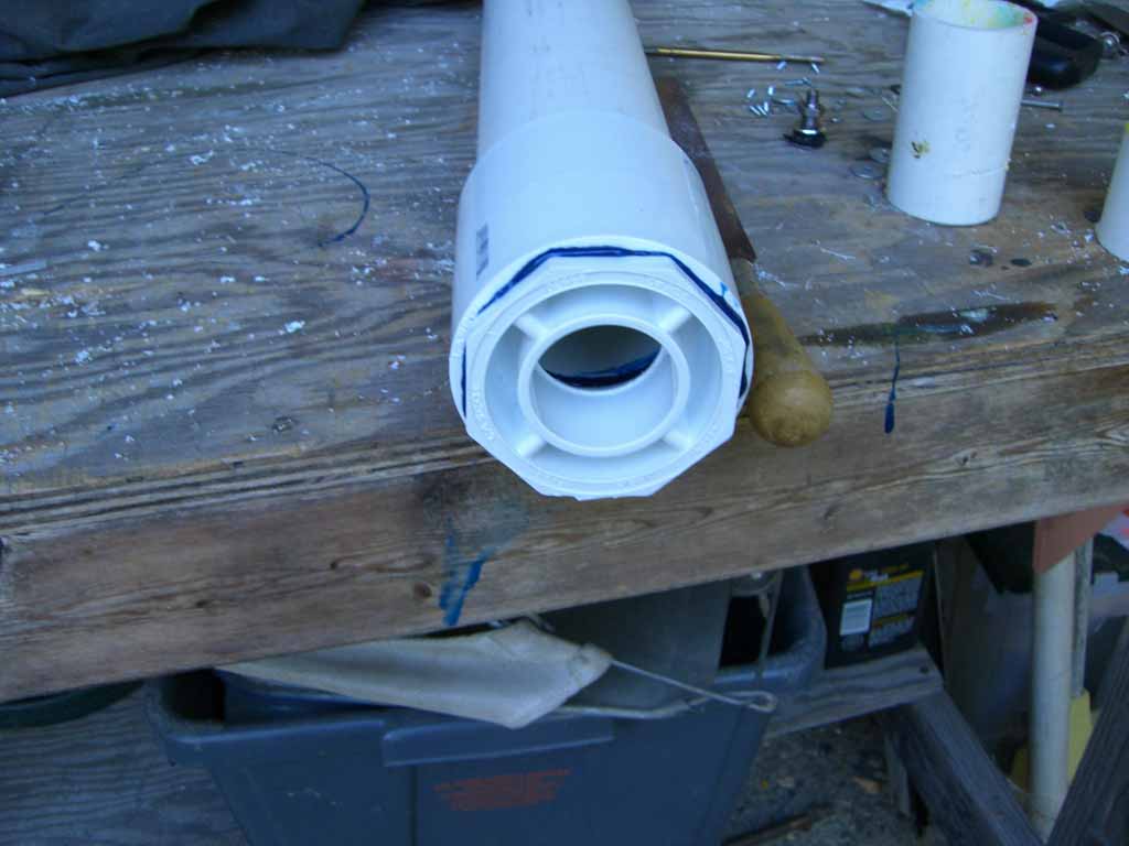

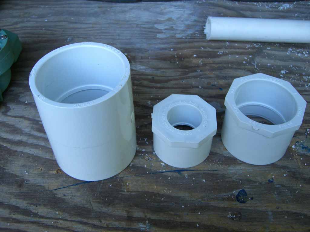

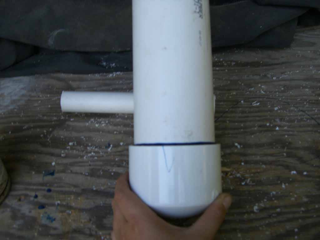

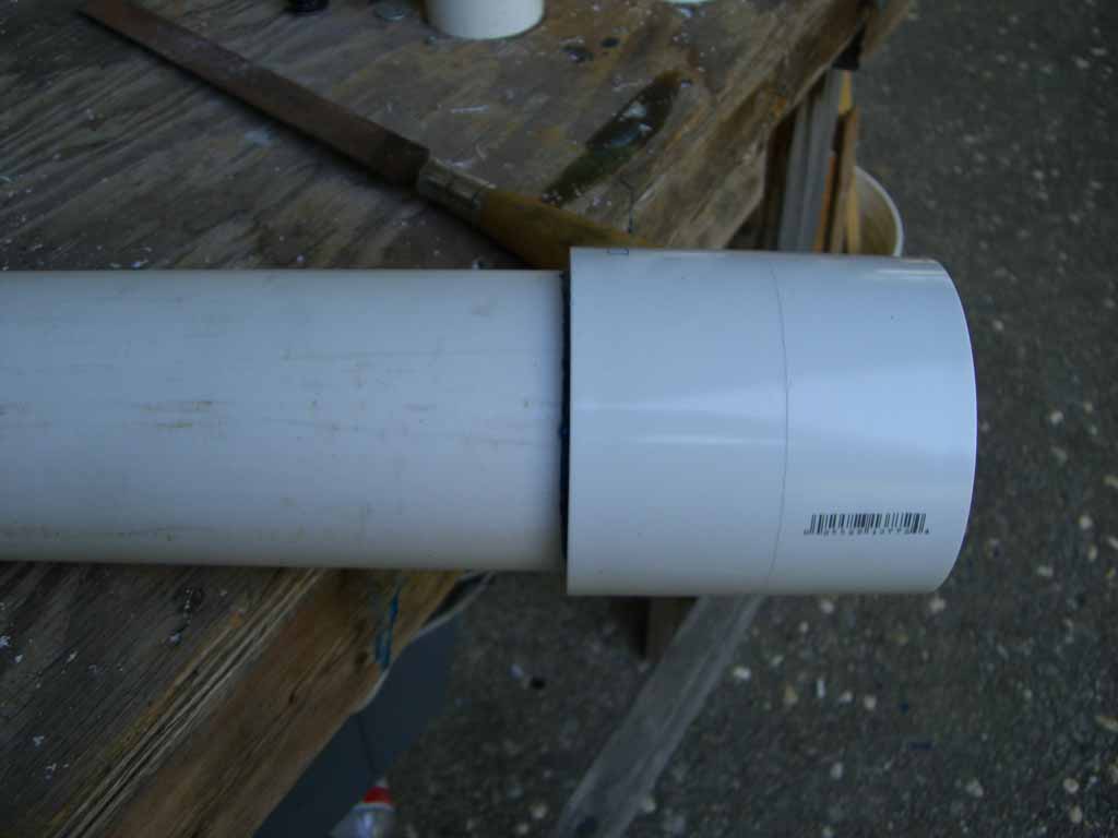

Alright so here it goes. Instead of spending $134.99 on Joel’s low power launcher, I am going to show you how to make one for about $100 less.
Materials:
1x 24” of 3 inch PVC sch 40
1x 24” of 2.5inch PVC sch 40
1x 3” coupling
1x 3” cap
1x 3” x 1.5” bushing
2x 1” male adapter
1x 2.5” coupling
1x 2.5” x 2” bushing
1x 2” x 1” bushing
1x slip x Mips 1” elbow
1x slip x Fips 1” elbow
1x 1” orbits water master modded sprinkler valve
1x 1-160 PSI ¼” NTP Pressure gauge
1x 1/8” NTP shrader valve
scrap 1” PVC
Teflon Tape
Tools (specialty)
1/4”-18 NTP tap
7/16” drill bit
11/32 drill bit
PVC Glue and Primer
START AT THE BOTTOM
Materials:
1x 3” coupling
1x 3” cap
2x 1” male adapter
1x 2.5” coupling
1x 2” x 1” bushing
scrap 1” PVC
Teflon Tape
Tools (specialty)
1/4”-18 NTP tap
7/16” drill bit
11/32 drill bit
PVC Glue and Primer
START AT THE BOTTOM
