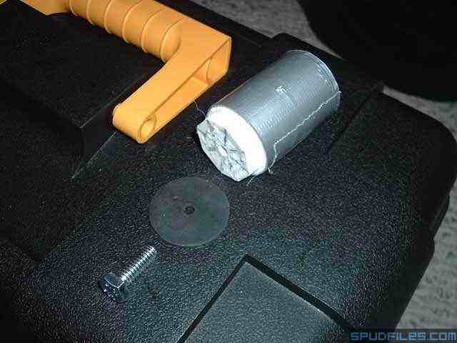

The duct tape wrapped doohickey is the piston itself.
This is the piston. Actually its the parts of the piston. Its very simple, just a .75&amp;quot; PVC coupling with a plug in the end and a rubber washer bolted on.
This is the piston. Actually its the parts of the piston. Its very simple, just a .75&quot; PVC coupling with a plug in the end and a rubber washer bolted on.
