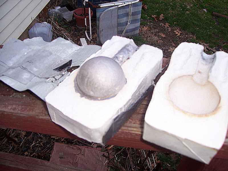

step 11, after the mold separated.

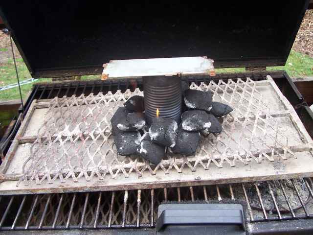

Yeah, thats how I melted my lead. I dont really recommend this though.
step 15.<br />If everything works right youll end up with something like this. you need to cut off the excess metal
step 15.
The finished product. mine ended up being about a mm smaller than my barrel.
