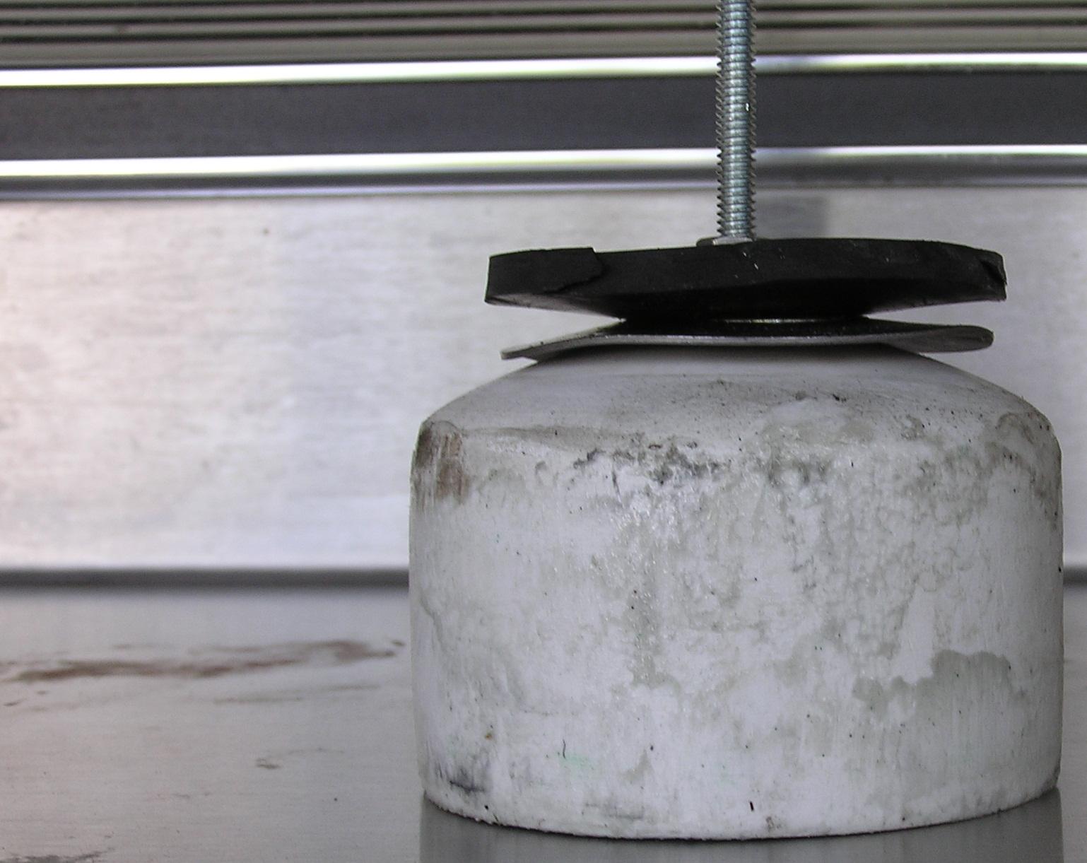

turbohacker
Posts: 392
Fri Jun 08, 2007 11:07 pm
It works great!!!
I reccomend using a slightly filed 3"cap as your piston as seen on my gun.

mopherman
Posts: 788
Joined: Sat Feb 03, 2007 8:20 pm
Fri Jun 08, 2007 11:13 pm
turbo, i just checked out your coaxial. I love the flanges ( or whatever they are called) how long did the sanded cap take? I only have a drill and a dremmle
edit: to avoid confusion, I meant pyromaniac not pyro. too many pyro names....
edit edit: sorry didnt see your pics. thought you meant the green gun
turbohacker
Posts: 392
Fri Jun 08, 2007 11:21 pm
Yeah, i just drilled the hole for the bolt dead center and mounted it in my drill press. I then ground and fit a few times with an angle grinder with a flapper wheel. A drill mounted in a vise would probobly work just as well...
