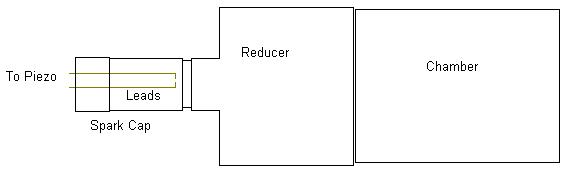

I began construction on the hybrid. I thought about using the spark plug but, once I realized I could not secure it without drilling a hole into the chamber, I scratched the idea. Instead, I built another "spark plug." It is made from a 1/2" pipe cap, pipe nipple, and coat hangers. The hangers are sharpened and secured through the cap with epoxy, where it is screwed onto the nipple, allowing 1/2" threads, which means no drilling through the chamber.
I hooked this up to a piezo and, although it made a good spark (the electrodes have a gap of about 1 mm), I am concerned with it igniting in 6x or more mix. I have recently disassembled a camera to use. BTW: It hurts like a b!tch when it discharges through the thumb.
My question is, has anyone ever used a piezo in a hybrid with 6x or more? If it doesn't work, can the camera sparker be used without running it through an ignition coil or equivalent?

I think nova uses a piezo at 8x. A gap of 1 mm will be fine for a typical grill igniter.
I don't think there's any way of using a camera flash in a hybrid without a coil of some type. The voltage is just too low.

Yes I do use a piezo at 8x mixes. I run about a 1.5mm gap so it would probably still work at 16x mixes at a .75mm gap. After i buy a shock pump i plan to build a 16x Hybrid_Fnord wrote:I think nova uses a piezo at 8x. A gap of 1 mm will be fine for a typical grill igniter.
Yesterday, I tested my hybrid. It fired at 4x so far, however, I had to hit the piezo several times for it to do so. There is still a small leak somewhere on the chamber that needs to be fixed so as soon as I fix it, I'll mount it on a stand (it's a pita to hold and fire because of its weight).
I was going to put JB Weld around all the threads and stuff to get a good seal. I let you guys look at it (although it's nothing special) when it's finished. Thanks guys.
Edited for a question: As mentioned above, I had to click the piezo several times before it fired. Do you guys think that if I extended the spark moreso into the chamber, that it would ignite faster? The attachment is how my current setup is:
- current setup.jpg (8.39 KiB) Viewed 3490 times

Are you sure that the wiring isn't shorting out on occasion?

Spark gap is about 1mm. The leak was coming from the nipple that connects the union to the reducer. This probably had a lot to do with me not being able to find my pipe wrench.
As far as the gap shorting out, the wires running into the cap are insulated and testing revealed it sparking every time.
I plan on rebuilding it and making the wires longer to reach more into the chamber. I also plan on removing all the teflon tape and just putting JB Weld on the threads to permanently seal it.
@Spudblaster: A picture would be nice. If you're referring to my spark idea, I thought it was original. Apologies.
