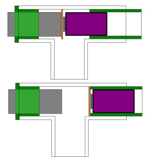

The way I built my 1-1/4" piston valve, the same seal that seals the barrel, also seals the piston chamber, when the piston is blown back.
Here is a pic to show the piston and it's seal in the two positions.
(Piston travel, etc, not accurate to any degree, of course. This is just for illustration purposes.)
By the way, this also seems to eliminate piston bounce.

mlz3000 wrote:That's interesting, what do you use as a sealing face? My neoprene washer just folds a little and slides inside of the pilot.
The seal is made of the red rubber you can get in small sheets at Lowes.
It has a fender washer on the piston side, to press it against the barrel. That washer is just less than the ID of the piston chamber. And smaller than, but close to the OD of the barrel.
It has a smaller washer on the barrel side. That washer is smaller than the ID of the barrel.

How do you service the piston if the sealing face stops it from going back?
The rubber flexes enough, that the piston can be shoved out of the piston bore, from the barrel end.Gun Freak wrote:How do you service the piston if the sealing face stops it from going back?
The washer on the very nose of the seal is small enough to allow that backward flex, when needed.

Your going in the same off topic direction as JSR. My goal is to get air from the pilot to the chamber while sealing 100%. Your idea applies if you dont want air leaking into the pilot area once the valve opens. I thnk JSR's idea is far more durable... thats why I've been using it way before I even started this topic.Oxbreath wrote:The way I built my 1-1/4" piston valve, the same seal that seals the barrel, also seals the piston chamber, when the piston is blown back.
If it cant go back then it must go forwardGun Freak wrote:How do you service the piston if the sealing face stops it from going back?
EDIT
Didnt even see your post...
If the rubber flexes so you can get it out, what keeps the air pressure from doing the same?
Sorry about that. You are correct. It was in fact, JSR's post that prompted me to post what I did.FighterAce wrote: Your going in the same off topic direction as JSR. My goal is to get air from the pilot to the chamber while sealing 100%. Your idea applies if you dont want air leaking into the pilot area once the valve opens. I thnk JSR's idea is far more durable... thats why I've been using it way before I even started this topic.
I didn't mean to hijack. I was'nt paying enough attention.
The bumper.FighterAce wrote: If the rubber flexes so you can get it out, what keeps the air pressure from doing the same?
