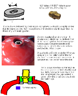

This may sound like a dumb question but how do i actually epoxy it in, as there is like a 1cm gap. Wouldn't the epoxy just run straight into the extinguisher???
What epoxy??
What fitting, HEX nipple ???

Thanks, now i feel better about using the brass nipples
