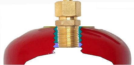

I now that i need to do my own trial and error in working out how to build and go about designing my air cannon but after months of reasearch i have got nowhere far. Many hours riding back and to Bunnings i have gone through at least 3-5 different plans on how to build a steel paintball cannon. As a last resort i have come here to ask a few questions (as it's getting bloody frusturating)
My problem is finding a suitable accumulator or pressure vessel.
I had purchased a fire extinguisher (made by FIRESENTRY AB powder type ) believing that the threads would be standard 25 mm (1 inch) though instead they are a custom non standard thread that's a little smaller than 1 inch. I have been to no less than 4 specialty stores (reece, eletrical store, special pneumatic stores, plumbing supplies etc) and have found no fittings that fit into it.

Is there anyway i can modify/epoxy in a smaller thread into the extinguisher?

You could conceivably make it as attached, I've done similar things for high pressure projects, you need the right epoxy though for a safe joint.jazzman56 wrote:Is there anyway i can modify/epoxy in a smaller thread into the extinguisher?

My one's threads were a tiny bit bigger than 1/2'' bsp so i just epoxied a 1/2'' male to male into it and its held 650psi at least 150 times now with out fail, i have a co2 type of FE but it will work for you to. If your one is steel then you have to paint the inside with anti rust paint to stop it rusting and possibly coursing it to fail.
