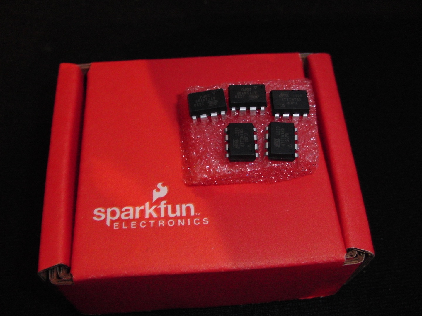

Look at what just arrived :D
took nearly 2 weeks to get here though :roll:
For those of yous who don't know what an ATtiny is, they are essentially micro arduinos capable of executing simple programs. Now I can finally get on with this hunk of plastic and epoxy.
