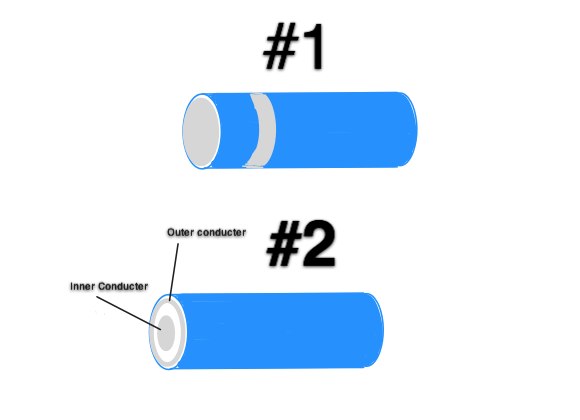

Here is where I need your help. I need to come up with a simple ignition system that can be easily duplicated on other cartridges. I'm trying to decide between 1: A sheet metal, circular cap on the back and a metal ring (tin foil maybe?) around the cartridge itself. And 2: A conductive ring within a larger one on the back of the cartridge. I could possibly use an etched circuit for this. For me, 2 seems like it would be much cleaner than 1, but I don't really like the idea of using that circuit etching crap. I've have bad luck with it in the past.
Anyone have any completely different ideas for the ignition? :?:

Have you seen the adhesive copper tape for leadlighting? Linky

Thanks Zeus, I'll look around for that. If all else fails I'll just super glue some tin foil to it.
