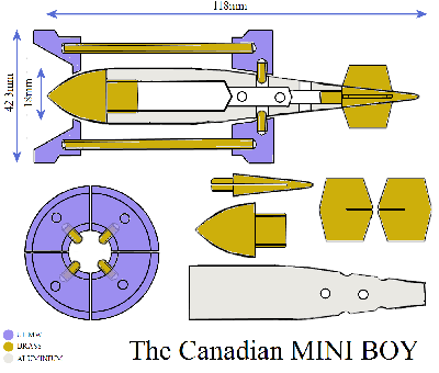

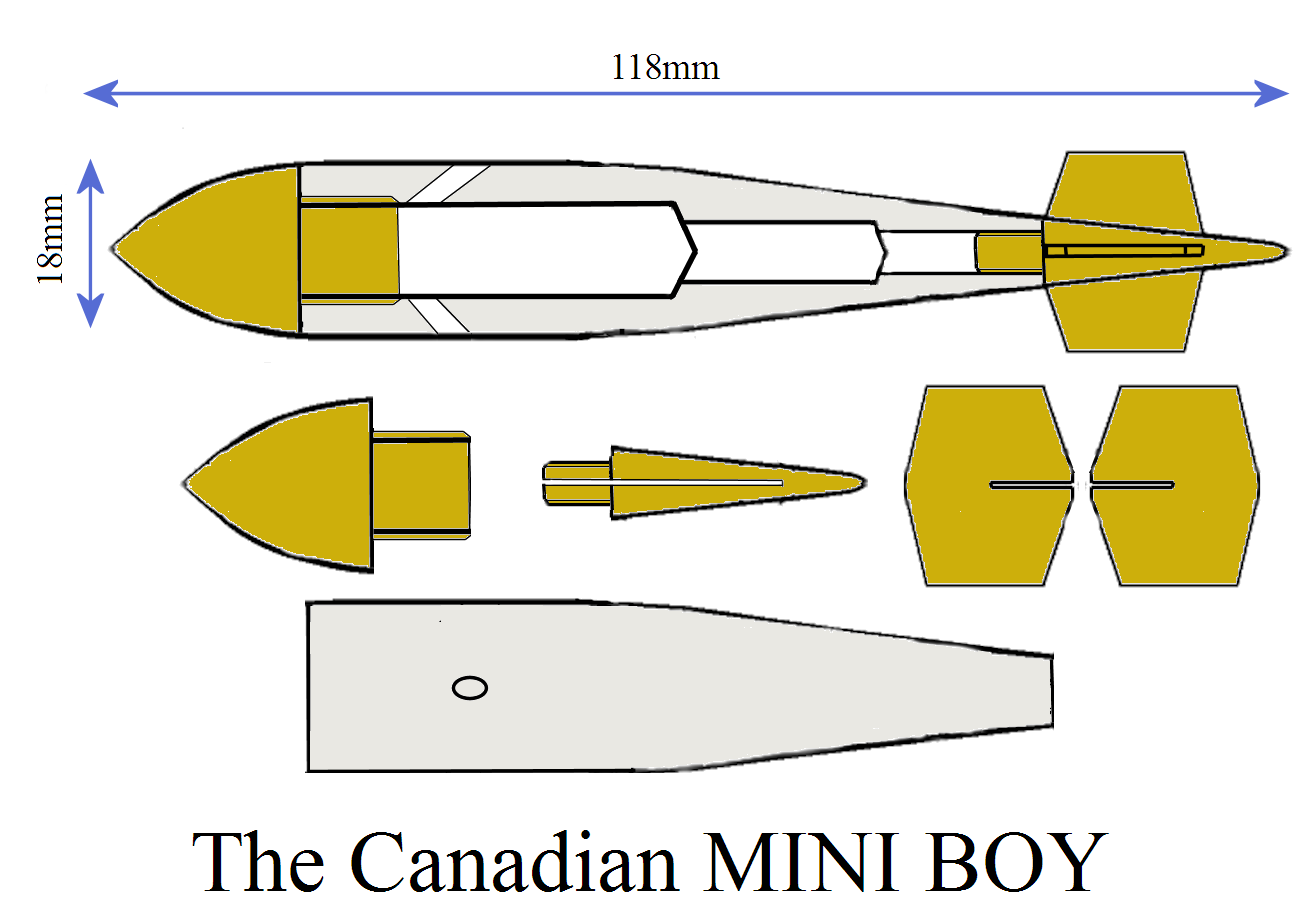

I draw a quick sketch based on the Tall Boy drawing.
Here's what I could do with the materials I have at hand.
The 4 holes at an angle near the nose are exhausts to whatever is inside.
Materials are brass and aluminium.
The picture is scaled to 10 pixels = 1 mm
What do you think?

It will go forward and make this MiniBoy Mark I, with simply some holes in it, just in case it is useful. Let's keep the homing device for Mark II!
Now I'm just wondering if the Brass + Aluminum have a chance to survive buried in the sand. My guess is that the shell will weight around 150 gr (empty). Can anyone with a similar experience can share it? I'm not talking about a direct hit on some hard object, just falling down in the sand.
Time to thing also about the sabot. I would like to make something so MrCrowley can reuse it, maybe with something else than my MiniBoy just in case it is lost at sea...

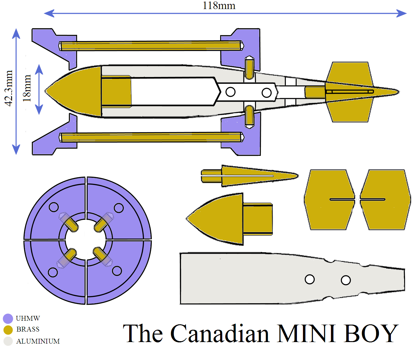

Here's my last thinking.
The tail now have 8 holes. When the sabot is in place, 4 are used as anchor points. So 4 are open to ignition gas.
The sabot is very light, made of 4 pieces of UHMW in front and in the back, linked with 4 brass rod. Will this have a chance to resist to the pressure and Gs?? I have no idea please tell me. Of course I could use steel threaded rods instead of brass.
The 2x 4 pieces of UHMW seem complicated to do but not really. The 4 pieces a gripped together in the lathe stock, then turned to size. A bit tricky, and I think fun to do too (well, fun when you like lathes).
Note that this is a sabot VERY specific to this particular shape
Any other ideas? More generic maybe?
[edit] oh I forgot. In flight the whole 8 holes are open, and could supply the oxygen needed as well as exhausting fume. Would this be enough?

That design looks pretty good. I think it will give the best chance for success if I used smoke powder so we may as well try it. I too have my doubts about smoke but all the other ideas seem a bit complicated except for maybe dye (which could be made to be nontoxic). A radiotransmitter would be pretty cool but I'm not sure how cheap I could make one for and whether it would survive the launch and landing.

edit: I would also be a little worried the 'pins' for the sabot will get stuck in the projectile during flight. If you prefer, LeMaudit, you can go with your original sabot as described in your PM where the rear of the projectile is sealed off but makes for a much more simple and basic sabot. I could then try and modify it to allow combustion gases to ignite the steel wool or I could just scrap the smoke idea and do as Tech said and have a few spotters up the beach.
You may still have to make the projectile hollow though, judging by jackssmirkingrevenge's calculations, ideal weight is somewhere around 100g even for such a small projectile.

nah nah... I was talking about smoke.. as in cigarettes.... bad english, french and all y'a know... didn't you see the center hole just fit one cigarette? With a nasty tobacco smell you should be able to find the thing... maybe with a dog's help...
With your experience with such powerful launcher, do you think the sabot would survive? or at least not crush inside the barrel? I really have no idea... no feeling at all if it's okay... I will surely replace the brass rods by stainless rods, just to be extra safe, but it's up to you and more experienced spuders to tell if it is safe for you to use that sabot design.

The only problem would be the temperature in the barrel, as UHMW melts around 150 degrees celcius or so. I still think it could work, perhaps only once though.
