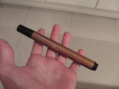

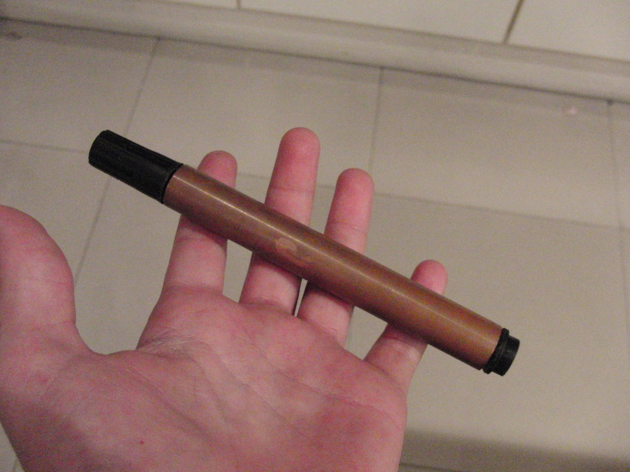

In all seriousness, do you think this thing would hold 800 psi even though it's thin walled copper? .66mm to be precise. I'm thinking no chance but the 3 inch long , 8mm barrel gives some pretty sad results to be honest @ 300 psi. Plus the the portability sounds pretty appealing especially after my crap zefal shocky broke
The thing with copper is that it's very soft, so under pressure it will stretch and pull away from the epoxy.
This project was fine at 500 psi but leaked at 800, on the other hand it was much larger diameter.
