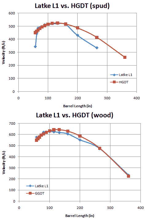

And in other news....
Don't know what to tell Jimmy or Spudfarm but....
I just made a slightly more intelligent guesstimate as to the effects of a chamber fan. Previously I'd just pulled "velocity delta" out of me arse. Today it dawned on me that the speed of the air driven by the fan might make an intelligent choice. I also corrected a bonehead on the heat transfer model (yes, Jimmy, there was an error that I've known about for about a week, but it isn't/wasn't enough to account for the things we're seeing). In any event, after doing that I was shocked....
- latke_hgdt.gif (10.76 KiB) Viewed 3369 times

Dave
So it looks like HGDT is hitting Latke's data perfectly (throw on Latke's error bars and there is little difference between the two sets of numbers).
IIRC, the two data points for spuds from the two shortest barrels are suspect anyway, so HGDT is probably doing better than it looks for spuds from a short barrel.
What did you estimate the mass of Latke's wood shell at? (IIRC it doesn't appear on any of his pages.)

1.2 oz.jimmy101 wrote:What did you estimate the mass of Latke's wood shell at? (IIRC it doesn't appear on any of his pages.)
I just guestimated dimensions from the photos and assumed a density appropriate for maple (or something that seemed appropriate at the time; don't actually recall).
