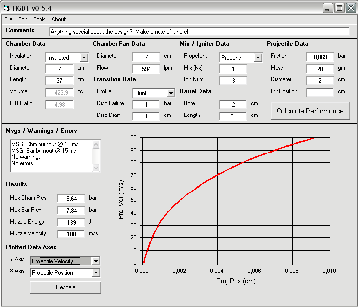

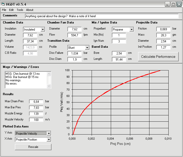

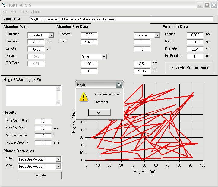

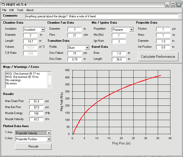

Here is a few screenshots.
The first is when i start the program, then i change it all to metric , after that i can remove all the decimals without affecting the result.

In metric with the decimals removed.
In metric.
In metric.

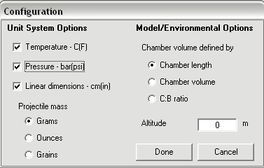

Configurations.
Configurations.
HGDT at startup.
HGDT at startup.

OK, based on the progression of screen shots it looks like....
1) Since you live overseas, you've got your computer set up to do the whole comma thing (where we use periods).
2) In some initialization stuff I assign some text values to some blocks. Those values are being inserted with periods (ie, as text, just the way I specified).
3) VB tries to deal with commas, but since there are some periods showing up... Well, perhaps some things are getting screwed up.
So what I've done: I just went in and reassigned some of those text blocks as numerical inputs. There's some type conversions and such... In any event, I've compiled a new version and uploaded it to the site. NOT in the .zip file, mind you. JUST in the "updated executable" location.

Doesn't work at all. :(

WTF?
For it not to have made any difference, I could have seen that. But to cause a crash? I'm totally confused.

Same problem now.

Where are you?
More to the point: What are the region settings on your computer?
edit: OK, for some reason I had imagined you in Sweden and set my region settings to that. Guess what? I can reproduce the error! Woohoo!

Good news: I know what the problem is.
Bad news: I'm not sure how to fix it without potentially causing other problems.
What's happening... Visual Basic is screwing up. When it sees "0,05" it stops at the comma. It just sees the leading 0. Result? Division by 0.
