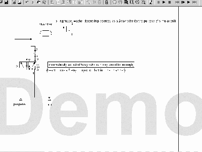

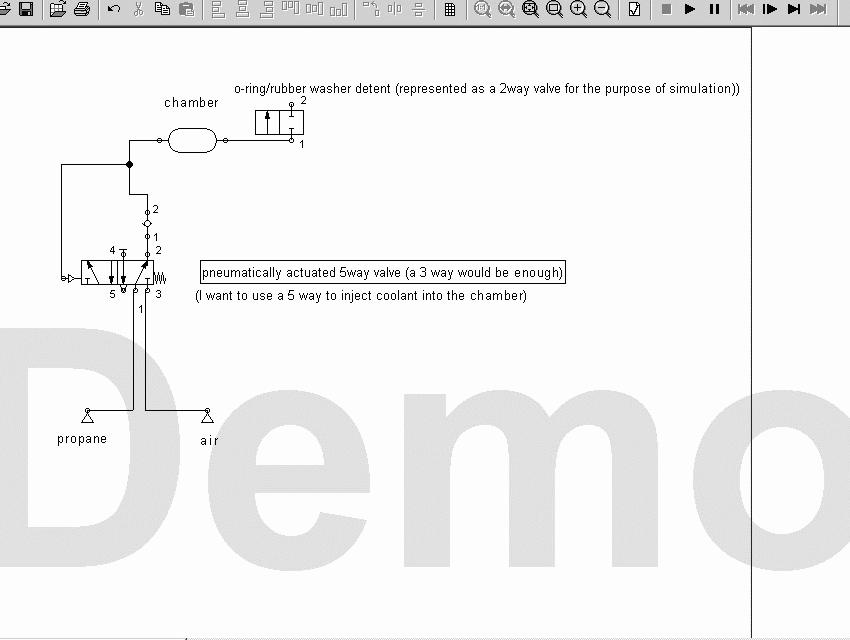

EDIT
Here is a circuit that could be use to automate the fuelling process.... the 2 way valve that you see in the pic is the detent... As you can guess it gets closed when the bb seals it... once the desired pressure is reached and the mix is ignited it opens
I think that the position of the valve can trigger the ignition... once the spool shifts a small switch sends signal to a timer relay that triggers the ignition with ~0.1 second delay (to leave enough time for air to enter the chamebr and fill it completely)
Ok I admit... it is not as simple as a typical burst disk hybrid but it can offer a lot more than a typical hybrid
what do you think ??
