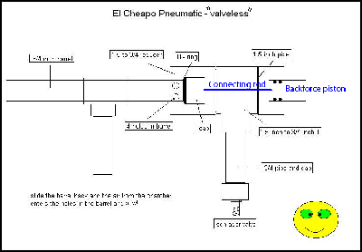

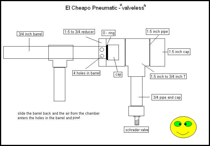

I got this idea from hotwired. so i drew a quick pic to see if u guys think it will work. should be cheap enough to make. the only special item would be the O-ring.
Hotwired wrote:A pneumatic.
It was a very odd design... it was a pressurised broom handle and the valve was a short plastic tube with one sealed end. Which was also the barrel.
Pushing the barrel further into the broom handle exposed holes cut into the side of the plastic tube and shot out the pencil or pen or whatever was in there.

You lied! You said you wouldn't use a valve! You used a schrader valve! I'm just kidding. In all seriousness, I thought it didn't work at first, but then I read the "slide the barrel back and the air from the chamber enters the holes in the barrel and pow!" part. This might be a little retarded, but wouldn't it be kinda hard to push the barrel back with so much pressure building up behind it?

technically this is a valve...... its the same valve used in inline Pump Paintball guns and the Airforce Condor..........
if you replaced the "pushing back" part with a hammer, youd have a kick-butt hammer valve gun.

It will work, but it will take:
pi*.5^2*100 = 78.5 lbs of force to open at 100 psi.
The radius of .5 is used because the OD of 3/4" SCH40 is approximately 1"
I say it would be pretty hard to open.

clide wrote:It will work, but it will take:
What if the end cap on the barrel was replaced with a cone?

Nit picking pizlo sees a problem here. You can't move it back instantly, so I figure your projectile will be out the barrel before your holes are a quater open. You probably willget bad performance because of this.

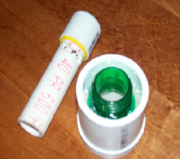

I found this on the search.
I figured ant would have an answer. The only big problem I see is it leaking a bit when the barrel begins to slide (other than the hard opening).
As far as a cone goes, one could surely be improvised or machined.

P.S. A cone has the same horizontal cross section as an endcap so the same amount of force would be pushing in on it.

Maybe if you could make the surface area of the cap behind the o ring really small if would make it a bit easier to push the barrel back. How big are the holes in the barrel going to be?
