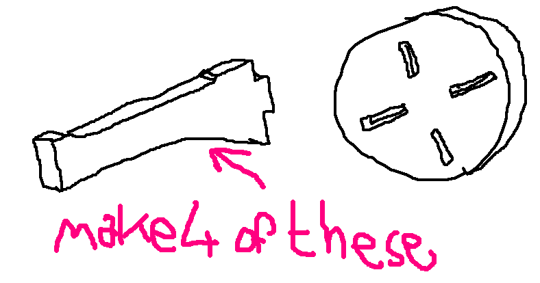

Well.... it could... With a base a bit thicker, meaning a UHMW disk + a aluminum plate.
Bolts like those would add very little weight (1 bolt+nut nylon is 1.3 gram, chicago is 1.1 gram) and would keep the thing together for loading and during the shot. Because If the petals misalign slightly, the projectile will not fire strait.
I'm now thinking that the petals could even separate that way, just inserted in a slot :-) If the slot is deep enough, rigidity would be kept. And with a bit of air catcher plate thingy on the front to help the separation....
hmmmm........ too many options :shock:
And I was ready to cut! Damn... I need to find my pencils... :lol:
[edit] JSR drawing: basically yes, but it is much easier to slot the disc all the way and just insert the plate in it. But I can hear you! "Who said it should be easy?" :lol:
Sorry dewey-1, it's all JSR fault!

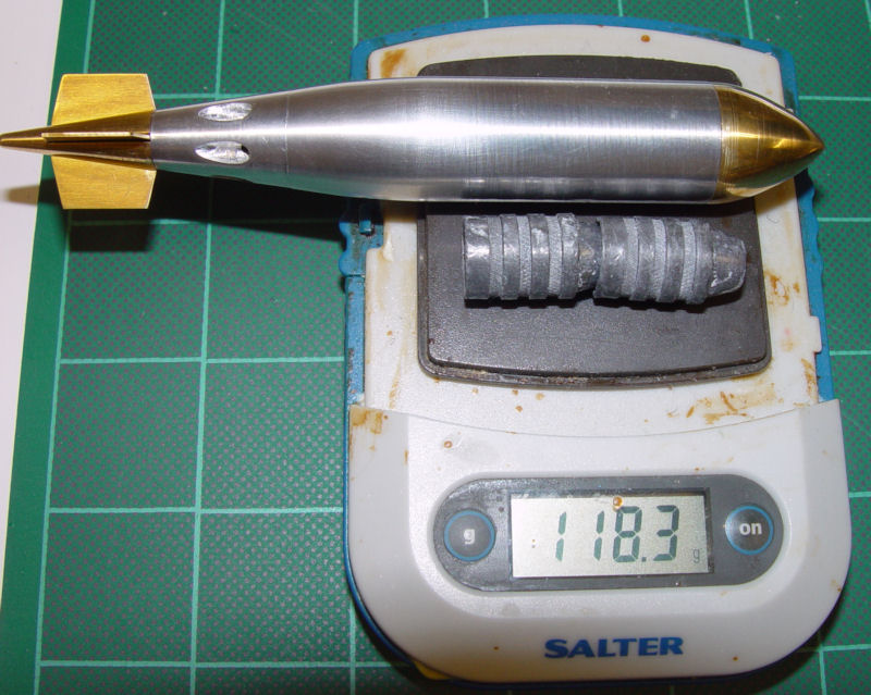

Every thing so far exceeds the weight of the projectile. (if it is 100 grams)
It's 68 grams empty... but remember it is supposed to be filled with tungsten bits. So I expect it will weight more than that!
Half filled with lead, it's about 120 grams.
[edit] that's what we need! Tungsten powder!!!
[edit2] And it mix with epoxy!!! Oh goodie!!!!!
Half filled :-D

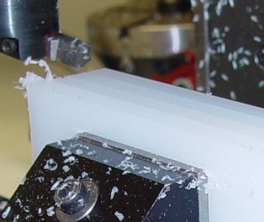

I'm cutting some UHMW right now... :D

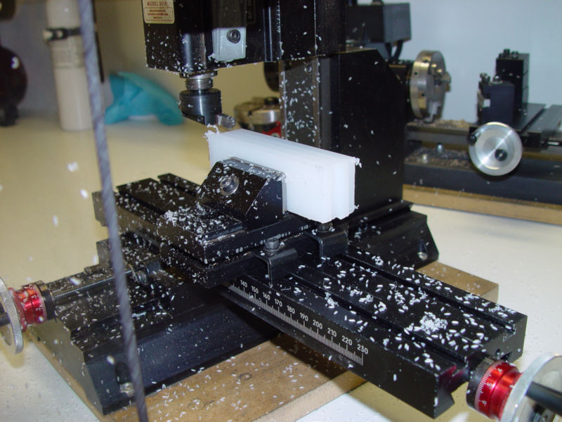

Niceee... is it UHMW?
UHMW do machine nice and smooth, I used a carbide fly cutter so far.
But the static is TERRIBLE
Looks like it is snowing inside the workshop :lol:
Forget what I said about machining on a kitchen table guys... not UHMW... any wife, girlfriend, mother, sister of female living creature looking at the mess would KILLYA!
Any tip to share for removing the static? incantations? miracles?
the wife didn't see the mess yet... somebody??
