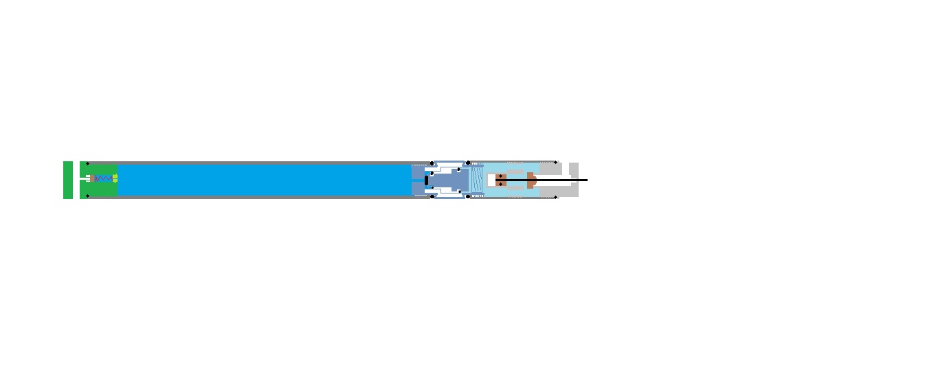

Also I have finished designing my pcp, still not final, but I like it.
My question is, the pressure I will be using is 200 bar in the main chamber, 120 bar after the regulator, how deep/length should the threads be?
- pcp.jpg (25.33 KiB) Viewed 5580 times

Four feet of class 3b FTW threads might work.
Are you SURE you're up to this?
You ask "how deep/length should the threads be" without providing the information that is required for someone to properly answer your question...You are demonstrating a total lack of knowledge on the subject, which is not good IMO. I'm thinking you need to do some homework on this.
200bar might not seem like much when you're merely looking at a number....but it CAN and WILL kill you if you give it a chance.
Please...DO the homework first...then we'll talk.
As far as your design goes...my own personal preference would be to have the o-rings positioned to isolate the threaded sections from pressure. When you've done your homework you'll be able to tell me why that is. And maybe a reason or two why manufacturers do it the same way you want to.
Do some research on "thread class", "thread shear", "barlow's formula" and "yield strength".

Wyz, if it we me, I'd go with the cheaper barrel. In a homemade gun I honestly don't think you'll notice a difference between the cheaper one and the really high quality one that Gippeto praises.
Wyz, you really should at the very least know enough about solid mechanics to get a general idea of the wall thicknesses and thread engagements required, and an understanding of how to avoid stress concentrators as much as is possible (and why you want to avoid them).
For building a handheld high pressure pneumatic, I suggest going one step further - learn to use an FEM program (RJB will have access to one) to take out the guesswork entirely. You'll end up with a much more lightweight launcher if you can predict more closely what the stresses will be.
If you're looking for learning material, there are loads of MIT lectures posted online, which are free to access. You should have no trouble getting an entire solid mechanics course (or three) from there. Alternatively, there are loads of useful texts available on Scribd and 4shared.

I know I'm going too fast, but I don't have much choice, I need to have the blueprint of all the parts ready before July. I knew I don't know enough as soon as they asked me what type of material I want the parts made of, I said stainless steel, then they asked witch type of stainless steel, I wasn't capable of answer.
But, the parts will be made by very experienced factory workers on high end machinerys.
I will do the readings, then let's see if I can get better.
I got a student version of inventor fusion 2013, but haven't find out how to use it to calculate material stress yet...
The reason why I want a good barrel is, with a straight 6mm aluminium barrel I´m able to have a groupo of 5cm dia at 25m, with homemade guns. As these guns I´m designing right now will be factory made, I want them to be better than homemade ones, like a 1cm grouping in the same distance.

I read this for "thread class", witch made me thinking about class 2 threads, I don´t want snug fit, I want the gun to be easy to assemble/disassemble;
For "thread shear" I only found formulas/calculators, but I got the idea, it´s the area of the threads where stress are applied.
Found http://en.wikipedia.org/wiki/Barlow's_formula for "barlow´s formula", and this is a question I forgot to ask. Originally I thought about 3cm ID and 4cm OD stainless steel chamber(witch type of stainless? I don´t know either
Studding http://en.wikipedia.org/wiki/Yield_(engineering)yield strength right now, already have a basic idea about it.[/url]
