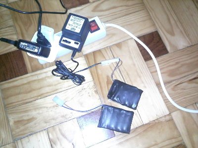

1.2v cell connected into two 6v packs, then connect them into a 12v pack, 1000mAh only sadly :(
dewey-1
Posts: 1298
Location: NE Wisconsin USA
Are those NiCd AA size cells or something else. A link will help me solve the problem.
I know NiCd sub C size will work.

Yes they are Ni-Cd AA cells, well I would post a link buy I bought them from a local electronic store :roll: and they this type is all they had, hope they works :?

I think not... I bought these cells individually then packed them.
camelion Ni-cd 1.2v AA 1000mah, that´s it

wyz2285
Austria
Posts: 2390
Location: Porto, Portugal
Looks like yes :lol: but my are cheaper :D
