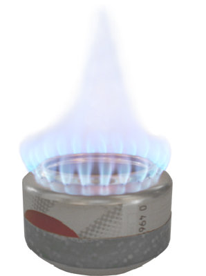

But jack is right.Methylated spirits is ethanol with a enough methanol and dye in it so that you won't drink it.
Methanol will turn to formaldehyde once your body processes it.Good if you want to go blind then save on embalming costs.But otherwise not a good thing to have around.
You can use ethanol or methanol in the place of Methylated spirits.I use all three in my camping stoves.Works fine.And maybe I should start calling them jet engines instead of stoves
All the guy did was make a very junky alcohol burner.

How many times have you made an alcohol burner?Burners are quite capable of busting glass and annealing metal for that matter.Soda pop stoves only last for a week or so before they get too annealed to be useful.And the reason they don't suck the flame back in is because they have proper air inlets so the flame doesn't have to die down before a new batch of oxygen gets in and the mixture combusts once again.If you took out the air inlet in the middle the burner would function as the Jam Jar Jet did.
Burners make lots of noise.If the jets are made right you can get sounds varying from a whistle to a full blown roar.

There are a lot of different types of alcohol burners. I was referring to the most common, basically a kerosene lamp which has a wick.
No noise. Can be operated indefinitely without any problems relating to heating of the fuel reservoir.
I've never seen an alcohol burner make much noise. Any burner that uses a forced fuel supply will make noise. Compressed gas, or heated volatile liquid from a closed reservoir, will make noise. An unpressurized system will not.
No noise. Can be operated indefinetly without any problems relating to heating of the fuel resevoir.
The "pulse jet" being discussed is an open system that behaves like a pressurized system.
The point is NOT what you can DO with the burner (melting glass, annealing metal) the point is what happens to the burner itself. Same with a propane torch, you can melt soft glass, anneal metal etc. but unless you leave the torch lit for a long time the cylinder does not heat up and fail.Burners are quite capable of busting glass and annealing metal for that matter.

Nope, that doesn't work similar to a "pulse jet". It works the same as a propane torch or Bunsen burner. Completely different mechanisms. Though the burner you are referring to does use some of the heat generated to pressurize the fuel.
The one you are referring to and burns continuously.
The other uses unpressurized fuel and pulses (hence the name). The pressure in the fuel reservoir oscillates between > than ambient and < than ambient
