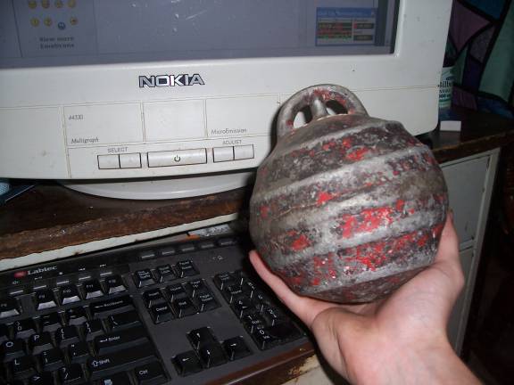

Ok, I got another idea for you. I just realized I already had something sitting around that is kinda like what you are looking for.
This is a bouy from who knows where. Notice how it appears to be made of welded metal rings layered together. If you have access to a cutting torch/welder, this should be reasonably easy to construct. It will take some time though, especially if you want it too look nice.
Does it have to be perfectly round?
