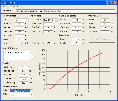

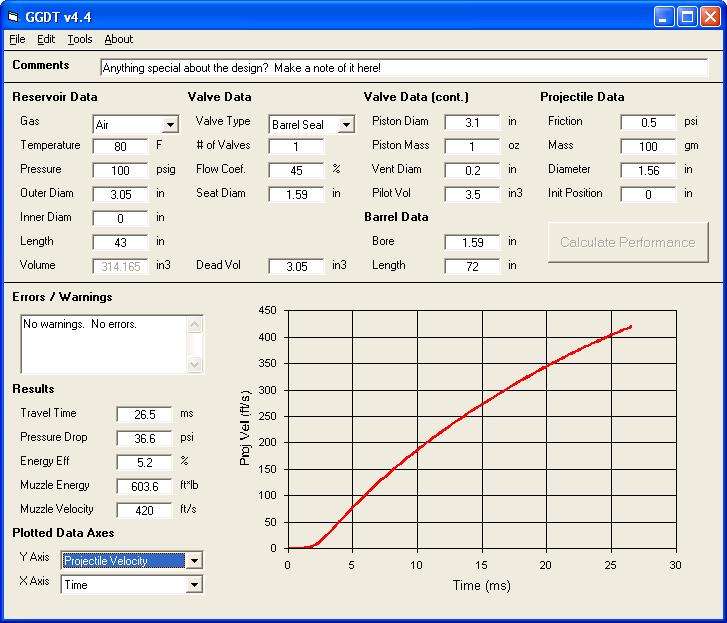

I hope you know that sarcasism isn't the easiest thing to read. Back to the topic. I want to build a barrel sealing pneumatic with a 48 inch chamber but before I did I wanted to see how well it would preform and how long of a barrel to use. But I don't think I am puting in the right input because the projectile never leaves the barrel. btw i'm sorry I didn't get to the point in the very beginning.MrCrowley wrote:Thanks for telling me all that in your first post. Why didn't you give me specifics? There are loads of things that could be wrong.veginator wrote:thats not the problem the program is working fine it's just once I type in all the stats it looks to be coming out wrong.so get off my back.

Without more info it is really hard to help you, but my guess would be that you are putting in the chamber dimensions wrong. Inner diameter should be set to 0 and outer diameter should be the ID of your chamber pipe.
Well I typed that in and it gave me some un expected results. I wound up with a gun that could have a 700 inch barrel. I think it's either the inaccuracy of ggdt or it is your advice or I am bust a moron who accidentally typed in a gun with a 4800 hundred inch chamber. So which one do you think it is.

A reasonably large pneumatic can have barrels that long before performance starts decreasing.veginator wrote:Well I typed that in and it gave me some un expected results. I wound up with a gun that could have a 700 inch barrel. I think it's either the inaccuracy of ggdt or it is your advice or I am bust a moron who accidentally typed in a gun with a 4800 hundred inch chamber. So which one do you think it is.
Are you using the gun optimizer to see how long your barrel should be? That optimizes so you will have 0 acceleration as the projectile leaves the barrel, which is LONG after the point of diminishing returns for most launchers, and definitely way longer than what is usually practical.
If you are using the optimizer, then you are better off manually changing the barrel lengths until you are happy with the trade off between power and size.
If you really don't think it is giving you the right results then upload your GGDT file and we can look over it (you may have to put it in a zip to use the spudfiles uploader)
Redid your input. Put inner diam to 0 (what clide suggested
) and changed your valve type to barrel seal. It came to 420fps.
