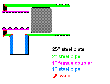

It has been suggested that I make a piston valve for my new pneumatic spud gun. (I posted pictures of it last week). I want to make the piston valve from steel pipe. Most of the examples I have seen here use PVC fittings to make the valve housing. Has anybody made one out of steel pipe and would you be willing to share with me any suggestions as to how best to make this valve?

I have a couple laying around. Here is how they are made.
- A 2" end cap is placed on the back. The piston is made from whatever you can find.
- valve.GIF (4.88 KiB) Viewed 1910 times

Thankes. Exactly what I was looking for._Fnord wrote:I have a couple laying around. Here is how they are made.
