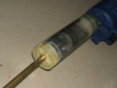

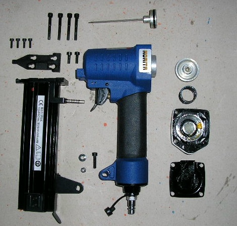

Following on from this project and my newly discovered love for air nailers, I decided to combine the two. This was the prototype before firing:

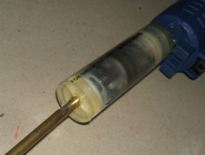

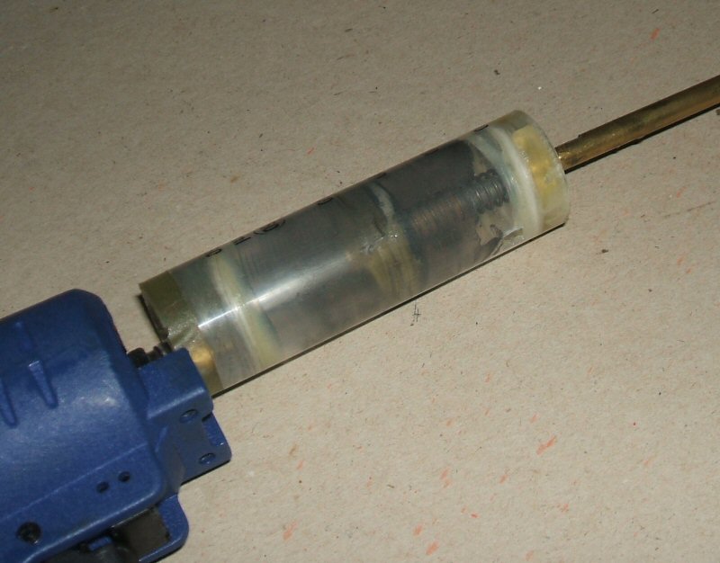

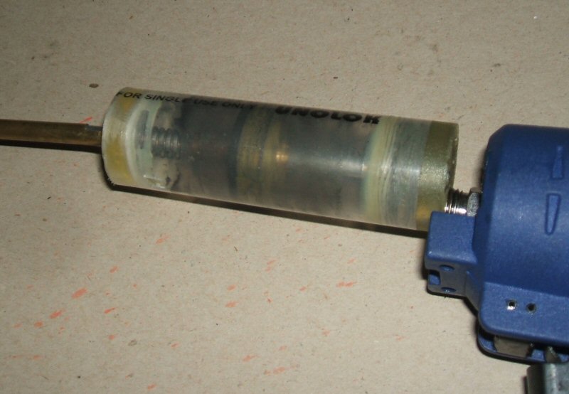

I basically replaced the nailgun's hammer piston with a 6mm port that fed into the blow forward breech I had made. I was expecting a considerable increase in power, it turned out to be a little too much however - on the first shot the bolt piston as well as the front end of the breech were shattered. as you can see from the attached photos, the bolt is jammed forward instead of having been returned by the spring. I blame this mostly on the air vent I had but at the bottom of the outer tube, had it not been there I'm sure the air being compressed would have cushioned the impact of the bolt.
I ran a few shots through the chrono, they were erratic ranging from 450-550 feet per second for a 0.25 gram BB due to the misaligned bolt allowing air to leak out of the vent, but still enough power to drive the BB clean through the bottom of a soup tin.
The current setup is beyond repair, I could make a smaller, stronger bolt but I'm thinking 6mm is a little two small a calibre for this sort of power, perhaps a semi-auto marble gun is a better idea....

should you build a larger area piston in the bolt to absorb more air and move slower or a smaller one to reduce the area that pressure can be applied
however I think you should try a blow back bolt like on paint ball guns, it should have less pressure on it to avoid breaking since barrel is always open to vent to the barrel

Hah, I never really figured out how to reduce the shock on the system and still get the speed and solid opening I needed. My inelegant solution was just building it stronger. I broke two casings at the front and I've just about broken 2 bolts (but one was defective).
I guess this doesn't really apply to yours since your is different than mine, but I found that if I made the big disk a solid fit so that it would have an air spring, I would just end up bouncing the bolt and getting leakage out the magazine. So thats why my bolt is all hacked up to just let air bypass the large disk thing that now just serves as a stopping mechanism for the bolt. I tried keeping the large disk solid and venting it like you did on yours, but that weakened it and caused the second casing to break (the first was just built too weak in the first place).

This is how the setup was originally, as you can see from the first video - I subsequently cut a hole in the vent to get the bolt to move faster - which boosted velocity by 50 feet per second in the original setup - I believe that had I patched that hole up before attaching it to the nailgun it would still be in one piece. I think I can make a minature version of your design massively reinforced with epoxy that could withstand the repeated hammering.

jackssmirkingrevenge wrote:Take a look...
Thanks JSR!!!
I had no idea there were so many parts inside. :shock:
Reminds me of a miniature jack-hammer(???)
On page 6 there was interesting info about preventing damage from slamming of piston.
