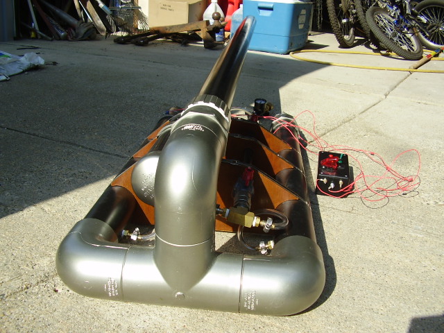

i do have a chamber fan in the cannon and i let it run while i inject the propane and while i am trying to shoot it. i will try to get a picture up so you can get an idea of how it works.
darknes
Posts: 16
Joined: Thu Apr 05, 2007 3:03 pm
hope you guys like my first cannon.
Dornep
Posts: 151
Joined: Thu Aug 09, 2007 5:49 pm
Holy Crap Batman!
That's an awesome cannon dude. Even more reason to get it firing! From what I can see in the pic it looks like your propane injection point is a good distance from your spark gap/s. I'm also guessing that your fan is near the front of the chamber also..
Also how big is your fan? Do you know how many CFM of air it moves? If it's very close to the end cap it might not be blowing hard enough to force the air towards the propane injection point. Which means your propane is just setting there, it will mix eventually but it will take forever.
My suggestion's would be multiple spark gaps if you don't already have them. And maybe another chamber fan, one per chamber side. Get that meter pipe volume measurement and I'm sure we can figure out the right mix for your gun.
It's a great looking cannon and it looks very well built. The control box looks great too... BTW are you sure this is your first cannon? :wink:
darknes
Posts: 16
ok everybody, i figured out the volume of the meter pipe, it is 79 cc. i do have a chamber fan and yes it is very close to the end plug but it still moves a little air, but i don't know how many cfm it moves because my dad found it in my grandma's old computer and gave it to me. also, thanks on the compliments on my first cannon, i didn't want to overlook anything.
