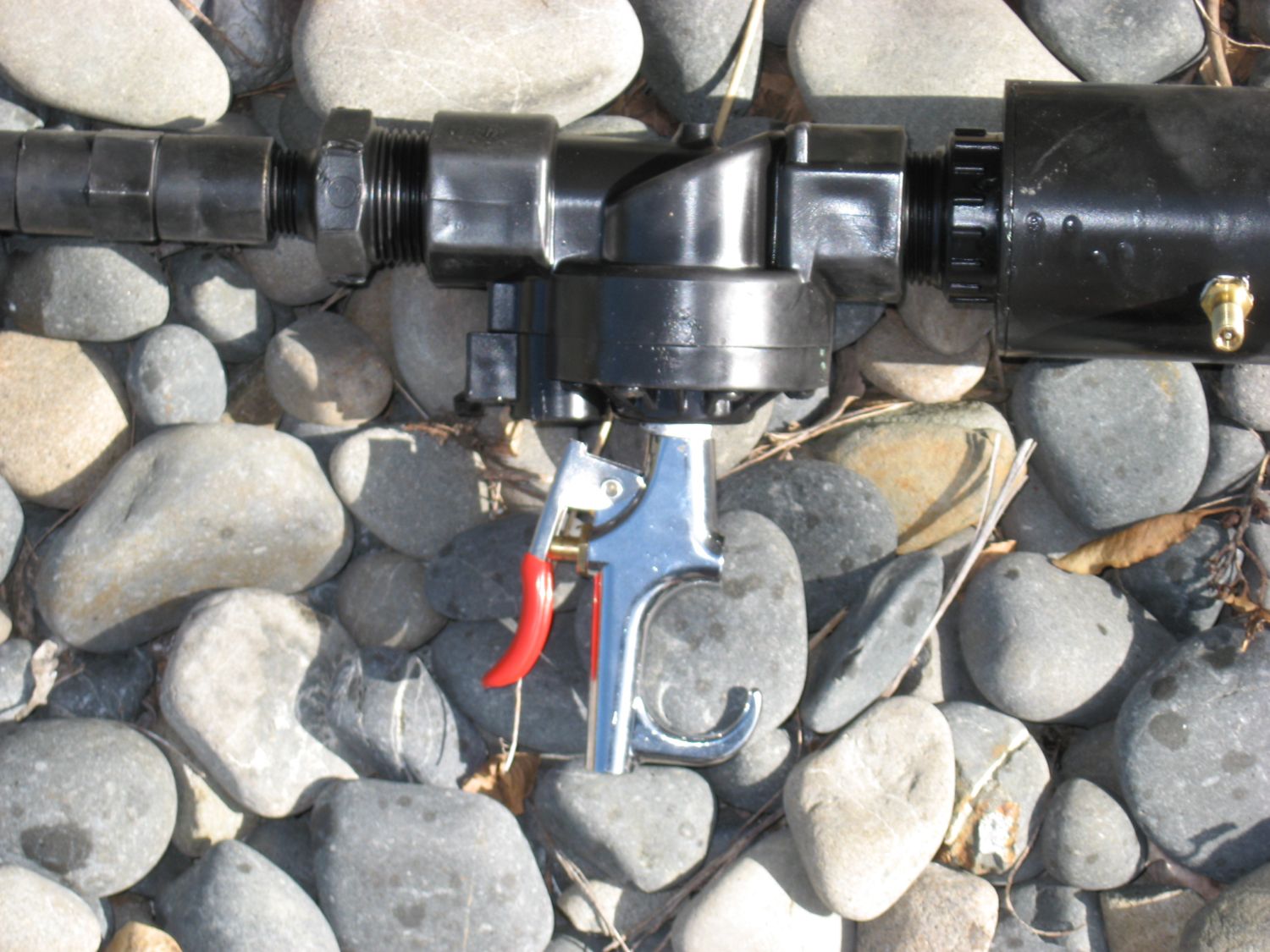

Well this is part of my imported stuff I got From America,
I call it SGI, as you may or may not know I name all my guns with SG (don't ask, it's German) and this one is SG-Imported :P
Simple but powerful, GGDT says around 600fps which is more then enough. All I wanted from this was a basic, reasonably powerful, portable paintball gun for Halloween :twisted:
Specs:
Chamber Diameter: 2"/50mm
Barrel Diameter: 1/2"/15mm
Chamber Length: 24"/600mm
Barrel Length: 36"/1000mm
Ammo: .68" Paintballs

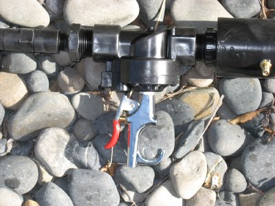

Valve: 1" Modded Orbit Sprinkler Valve
Pilot Valve: Standard Blow Gun
Fill Valve: 1/8" Threaded Schrader
Extras:

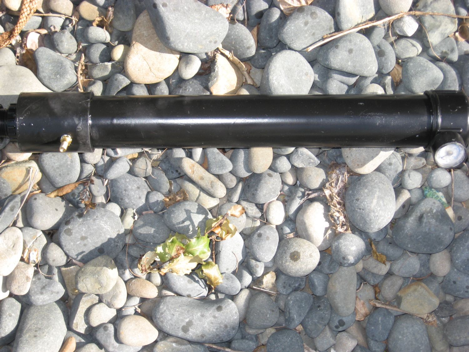

160psi Gauge
Bell 120psi Shock Pump

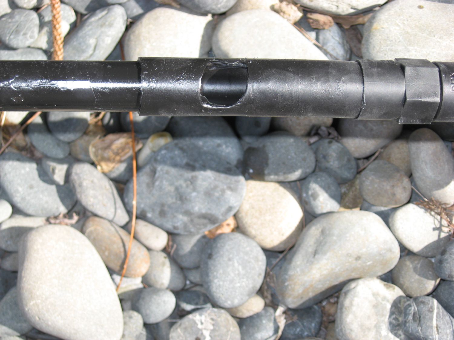

Breech Loaded
Chamber
Chamber

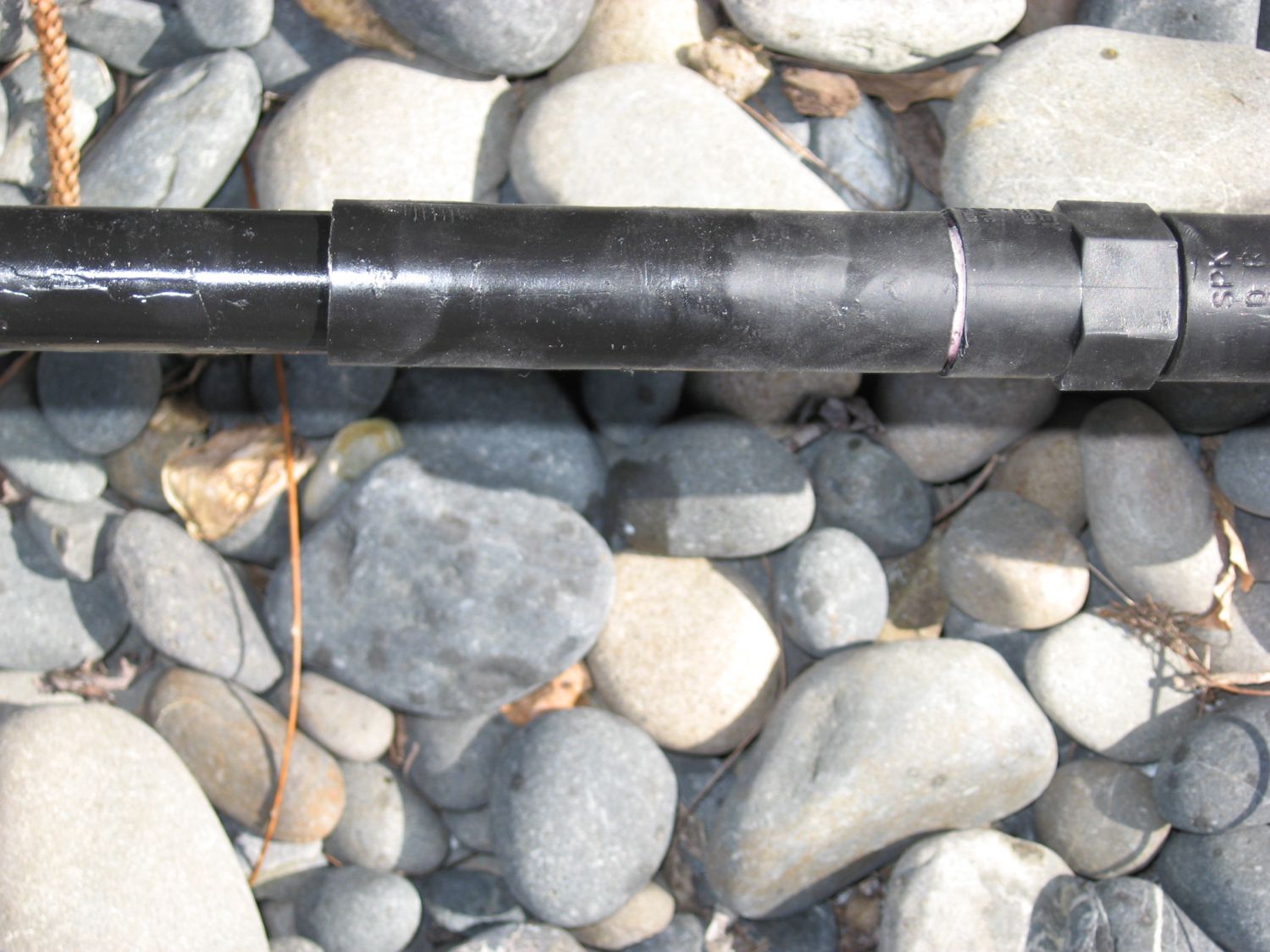

Closed Breech
Closed Breech
Open Breech
Open Breech

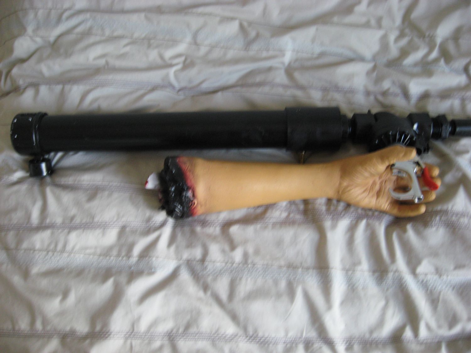

Shooting Lefty
Shooting Lefty

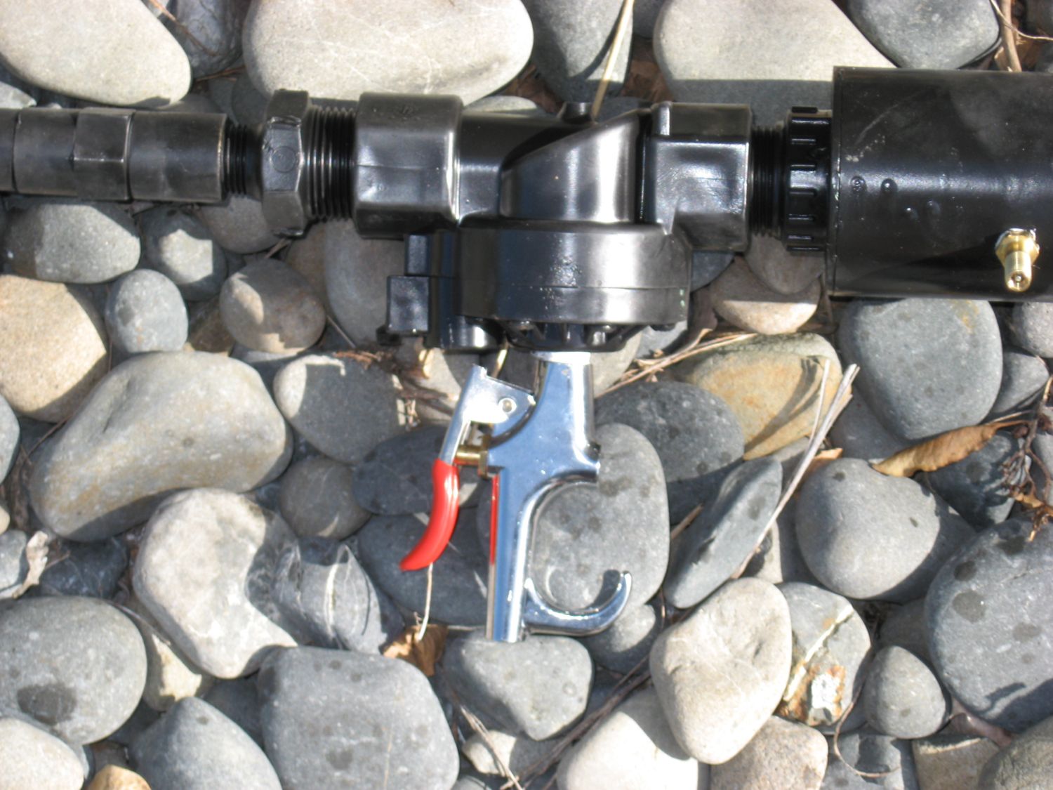

Valve Setup
Valve Setup

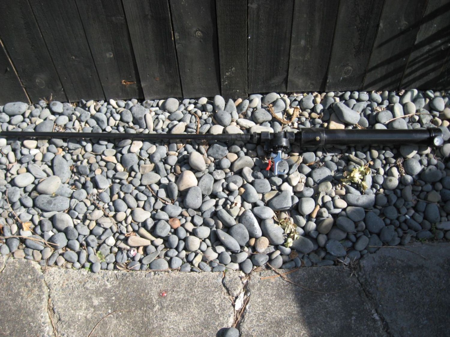

Over View
Over View

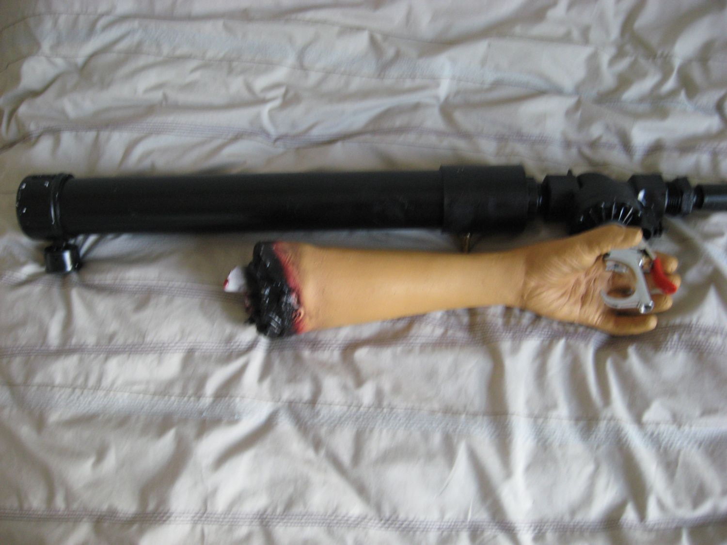

Hows the accuracy? The arm on your bed scared me :lol:
-Bad religion
Yeah, I wanted a JB Weld free gun that doesn't require maintainance all the time. Accuracy is good, in the video I hit the edge because I wasn't really trying and I was standing shooting from my hip.
Haha I got that in America, yeah that's right I brought that through customs :P The X-Ray team probably thought it was weird...and Arm with no bone :D

Nice simple gun Mr. Crowley, but that arm scared the f*** out of me when I first glanced at it. lol

What did the people at customs say when you tried to bring all those supplies with you? (amazing cannon by the way)
They didn't say sh|t :P
>>funny picture lol!
