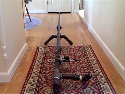

This is my biggest cannon, it's the first one that I've posted on this site but it's the sixth or seventh pneumatic that I've built. The pictures aren't that great, but they should good enough.
Specs:

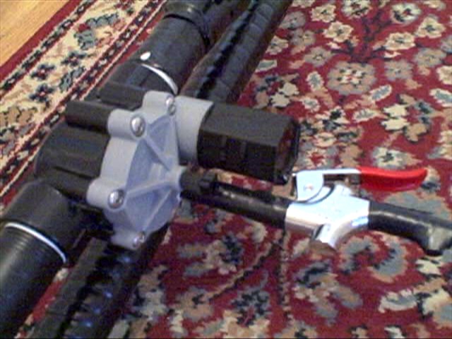

1" modified sprinkler valve
76 inches of 1'' diameter black iron pipe for the chamber
72 inch long .75'' diameter barrel with a ball valve breech

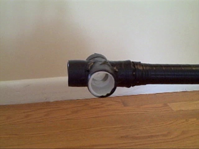

.75'' "cross" connector for a muzzle brake
The gun was supposed to look like the Barret .50 cal. but it doesn't really look like it, either way, it has a decent amount of power for a paintball gun.

The valve
The valve

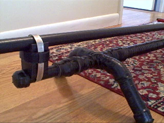

The bipod
The bipod
The muzzle brake
The muzzle brake
The full view
The full view

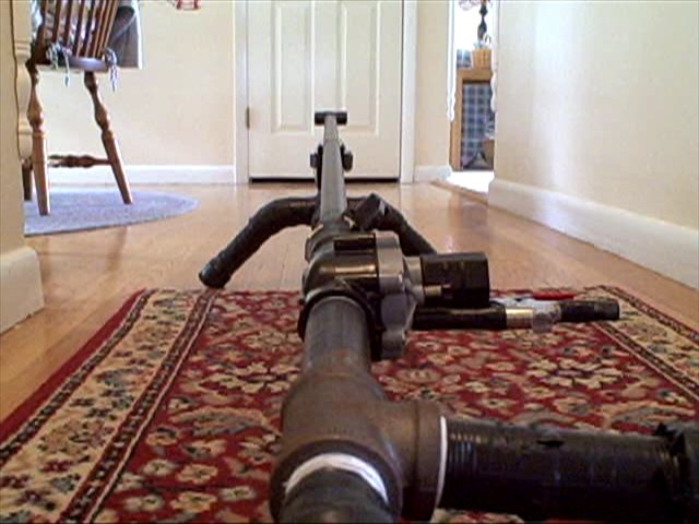

Down the barrel
Down the barrel

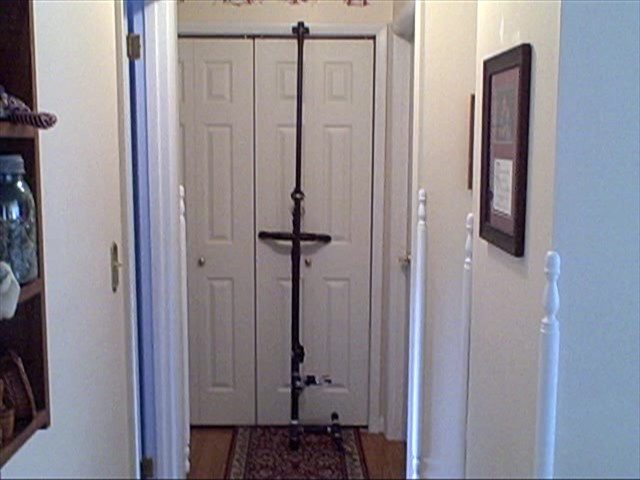

The height of the cannon (almost 7 ft.)

e1337 wrote:Very nice, the stock looks kind of weird can you explain how you use it. What psi you run at, and i doubt that the cannon makes the noise on the video. Any way nice cannon
nice,e1337
Well, I had some extra 1'' pipe fittings laying around, and when I had the gun hooked up to the compressor, the hose got in the way so I added a piece out to the side that would keep the hose out of my arm's way. My compressor only goes up to 100 psi, so that's what I usually run it at.
