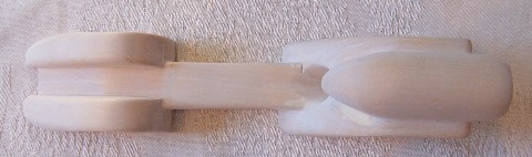

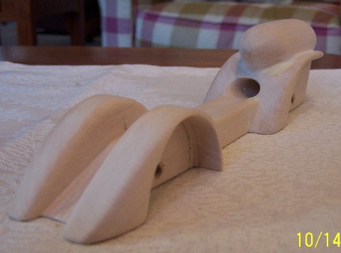

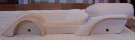

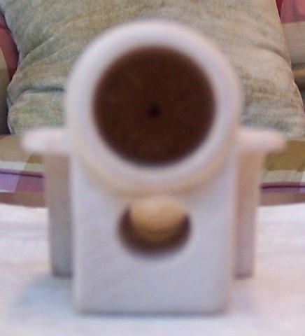

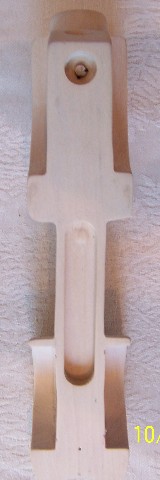

Hi guys, I dont know how many of you are familiar with co2 cars, but I will explain how they work. A small 8g co2 cartridge goes in the hole in the back, and they are set side by side on a race track. A small needle electronically punctures the back of the cartridge, and they race down the 65 ft. track at around 1 sec. My car isnt finished, but I thought I would show it to you anyway. It obviously needs wheels and paint, expect to see them within a week. This is for a Power and Transportation Tech class. I also plan to install brass bushings and axles.

Very slick, i'm guessing the final result will be sealed, painted and wax polished for that few extra feet per second
what wheels will you be using?
By "opening" the cartridge, you mean to propel the car in a race? That is described in my first post, it is some sort of electronic puncturing needle.
EDIT: Jack slipped in a post as I was typing. Yes the car will be sanded with 600 grit, painted, and clear coated. The front wheels are going to be standard PITSCO wheels and the back wheels will be PITSCO GT-R wheels, I dont know if you are familiar with them, you will see them in about a week anyway.
Sweet, but they look a bit wide for speed...
right, I didn't realised width was limited by regulations.
