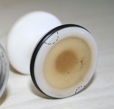

I have only tested it to approx 80psi, at witch my tight fitting ammo has trouble leaving the barrel
This worries me, are you sure that enough air is flowing from the pilot chamber to the main chamber? Maybe you should make sume notches in the front of the piston as suggested below:
Thankyou JSR, i had the same worry. Suggested alterations will be carried out tomorrow, i'll use a 6mm ball nose cutter, is that large enough if i make two grooves do you think?

experament-u2 wrote:why not drill two small holes instead of cutting out part of the oring? just a suggestions. what are you using for your barrel?
If you drill two small holes, that will let the air back through the piston when you activate the pilot. By cutting groves in the front as I suggested, you have effectively created a check valve that allows air forward while filling, but seals when you activate the pilot.
That should suffice, you can use this pump piston head as a reference.
